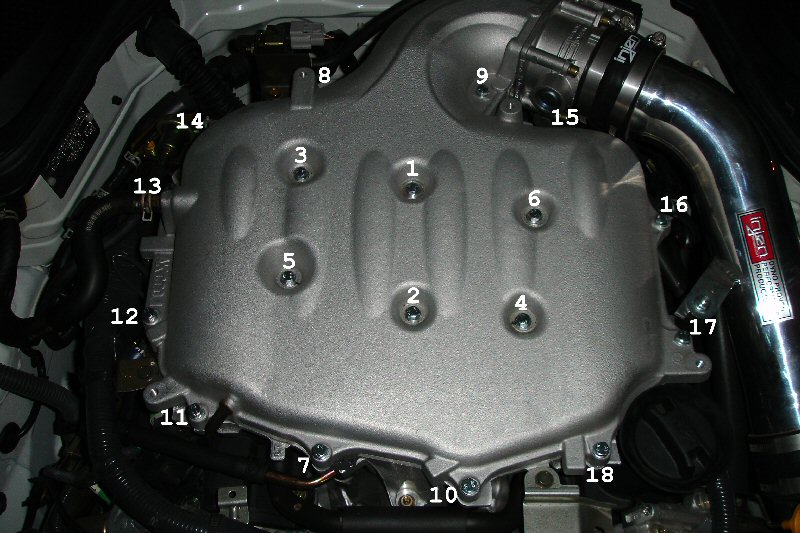

I completed the install this weekend. Was pretty easy. Had to pick up a new Craftsman toraue wrench @ Sears on Saturday morning.
A buddy came over and we installed it in about 3hrs. Of course this included beer breaks in between.
Only difficult part I found were the little retaining clips that hold the hoses in place. Sometimes it was hard getting my hand into little crevices, inorder to remove the clips. It's not impossible, just time consuming. While I had everything off I took the time to spray some car cleaner in the throttle body and clean off some of the built up carb deposts & dirt that accumilate over time.
I had no problems with the gasket. In fact, it didn't even come off the engine block. It was a thin, hard, black metal gasket that is actually attached the the engine block with some type of metal plate...
Everything looks great. No leaks. Torqued everything to 61 inch lbs using the diagram I snatched up from another website. I torqued the bolts in three sets, like someone mentioned earlier: 20 inch, 40 inch, then 61 inch lbs.
Thanks for all the info guys. I'll post pics tomorrow.
(attached is the bolt tightening sequence)

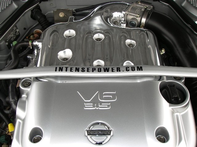

as promised...

nice!!! love the look w/ painted engine cover!

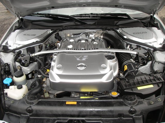

Here's the rest of the engine.
