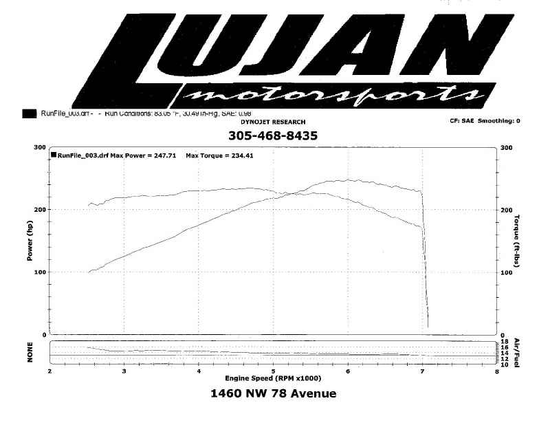

Was by a Lujan Motorsports today with a friend asked if he'd mind strap me in for some quick runs. The car originally dyno'd 236whp and 209TQ on a AWD dyno uncorrected.
MODS:
K&N Filter
MREV2
5/16" spacer
2.5" True Dual w/X-pipe.
Out of 3 runs Best was-
uncorrected: 254 WHP/ 240 TQ
SAE corrected: 247WHP/234 TQ
1st Run was 241WHP/229TQ, 2nd Run 246WHP/232TQ SAE (Forgot what the STD was)
If you compare uncorrected to uncorrected I gained 18 WHP and 31 lb/ft of torque.

your torque was unusually low on ur baseline. Im sure you had a torque gain but not 31 ft. lbs.
Old Dec 29, 2006 | 07:15 PM
diablo25mn's Avatar
diablo25mn
Posts: 132
From: Miami
gotta remember that its a 2006 Rev-up. So I had more whp to start with a less torque than the 287 motors
