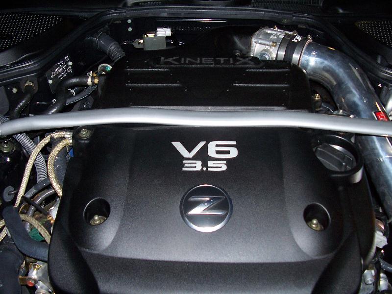

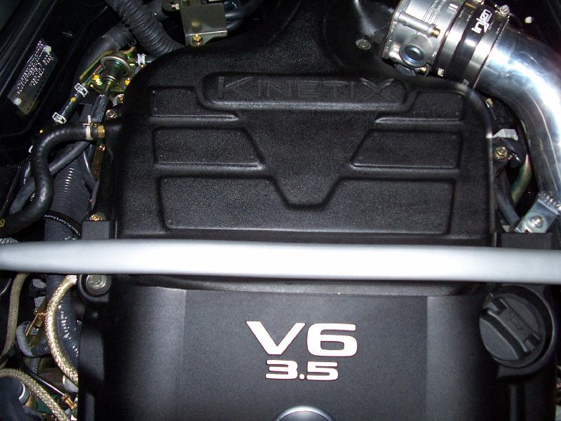

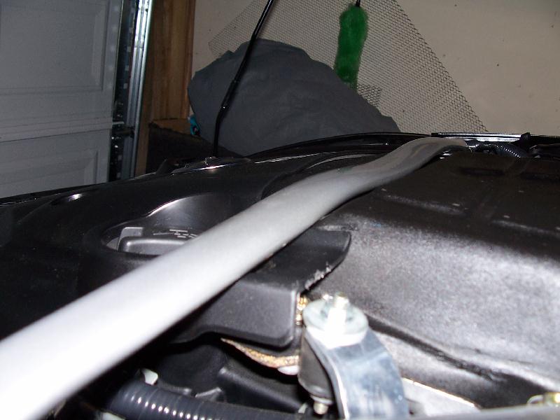

here's a few pic's to show you the clearance with just the plenum, I will be adding some spacer's this weekend.
