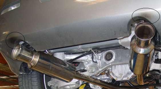

I take it the bumper's been burnt? Is this from this particular exhaust system?

HOLY *****! Those fools at Injen BURNED THE CAR! I can't believe I didn't notice this earlier...Hah, that is amazing! I can't believe this crap went market...I knew there was something up with those crazy angled tips
Even if that was from a previous (faulty) install of the same system they should have at least touched it up before using those photos on their site!

just so you know, someone already posted on this issue exactly. The president of injen said that the problem had already been (or would be) fixed on production models

The Injen makes the power, but if you notice, the exit angle of the tips doesn't match the cut out in the rear valence. The cut out's were designed for pipes that existed straight back, not from a 45 degree angle. That's why you see the "burning" of the paint. Either the tips burnt the paint or the exhaust is leaving soot deposits. Both are bad.

I already said that Ryant of Injen said that the tips are gonna be fix by the time the system is out.

Just from looking at the pics, it looks like Injen could just "slightly" bend the pipes to make the tips straight. A minor bend on each one would fix the problem and not make it much more restrictive. It doesnt have to be a sharp bend, it could be gradual.
