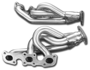

Hello
Does This Headers ( Stillen)
Fit with the Stock Gasget ???
it looks different , but the nissan dealer says yes it will fit
but iam not sure wheather it will fit or not
because i recived the headers without gasgets
and stock gasget i think is little bigger than the stillen headers
what do you think <<

it should be able too, i wouldn't see why not.

why because
the gasget is coming from 3 equall parts in one piese
but the headers 2 parts equall and the middle is same as the gasget
thats made me little confuse
for the middle it;s ok
how is it on other 2 parts ( the right and left )

Thanks for the photos.
I say yes. All that you have to seal is the 3 manifold to header ports. They are an exact match. I cannot remember but is the right and left OEM gasket the same part number? I assume so because it has 12 bolt holes. The header has only 8. I assume that the gasket can be flipped, and used on either side.

I would call stillen to make sure, but it looks like it will work fine.
By the way - I would use new gaskets when you do the install. Don't re-use the old ones. It's just not worth the possible trouble.
THANKS
sure i will use new gasget for manifold
that's why i am asking
but i will keep the same back gasget
( connected to catalyst side not engine )
since i installed a test pipe only 2 week ago
thanks again and waiting for call response

if the stock gaskets are still in good shape then you should be able to reuse them with no problems. The pictures do look different but the gasket should slap on there with no problem. The stock gaskets are as good as they get, so i would use them if possible. (or buy new ones to be safe) Good luck with that install, its going to be a knuckle buster.

Every thing is ok
stock gasgets fitted 100% with Stillen or DC headers ,
