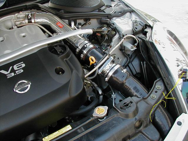

First take off that little plastic intake piece. I guess it's in the injen instructions but here's a pic of the location.
then, put a little dish washing soap and a little water on the silicon tube, slide the tube up from the front squeeze it hard and keep pushing it up into that same hole, as it starts getting through, you can just pull it from the engine side and rotate it so it's in the correct position.
It was definitely harder doing it without the bumper off, but once you take off the bumper once, you don't want to do it again unless you have a lift.
Yup, the hardest part of all was the damn heatsink.

I cant get the little intake piece out (I think thats what the above post is refering too) without seemingly removing the bumper.
any suggestions?
Old Jun 12, 2003 | 09:17 PM
islandsnow's Avatar
islandsnow
Posts: 1,008
From: Torrance
Default it comes out with a little force
Actually, it hits the front part of the bumper, but if you pull up on the plastic as you pull it forward, it almost feels like it's gonna break the plastic, but it doesn't, it eventually just pops out. I was scared to do it too, but others have done it the same way.
