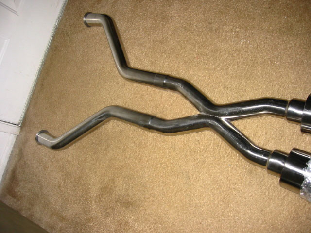

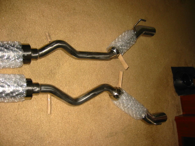

Default Anyone have this exhaust? **Bought & live pics**
It looks bad *** for flow.
http://www.dezod.com/pd_dezod_motorsports_xpipe.cfm
I bought this, and have it in my living room.
Ok. Sound verdict:
UNREAL! Clean, aggressive, but not over bearing. The sound is EXACTLY what I was lookin for 100%. Even the mechanics that installed where like 'man, this **** sounds good....'. So my summary 4.75 out of 5 for sure.
I will post sound clips in a few mins.
dezod motor sports 2.5" x-pipe FTMFW!!!!!

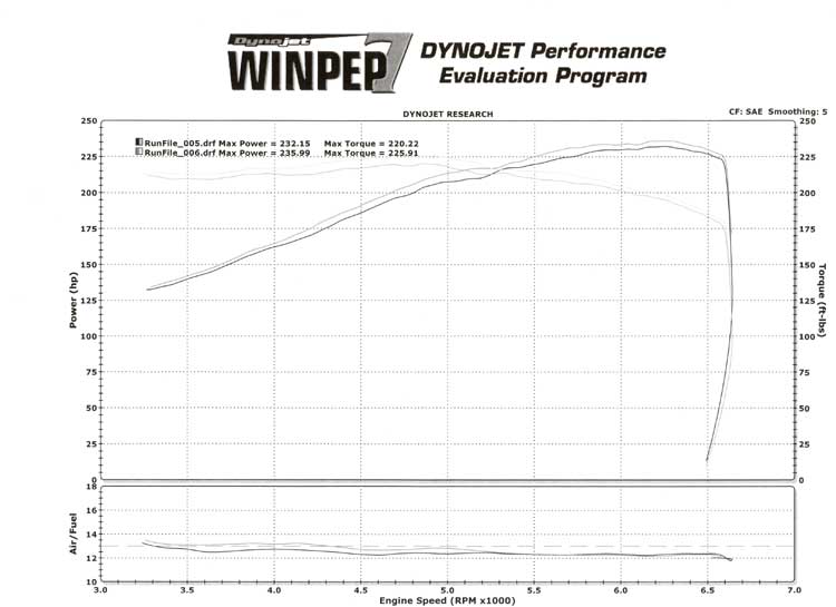

dyno!
I made 232.15 whp and 220.22 ft/lbs with the OE exhaust
I made 235.99 whp and 225.91 ft/lbs with the Dezod 2.5" X-pipe exhaust
Gains where all accross the board and not just peak. I have the before and after overlaid. It sounds great at WOT, but my camera died 100% today. It's officially busted. No pics or video. I think I am getting headers and test pipes next!

My buddy Joe owns that place, he had it on a customers car before, its nice but loud seeing how there are no mufflers.just pipes back

Yeah? Seems like some top knotch craftsmanship. I would imagine it being aggressive in sound. The resonators on there seem pretty large and should do pretty well with sound suppression.

too bad the install pics dont match the product pics. One must have been a proto or something.

I called and confirmed, the on cat pics are a proto-type.
