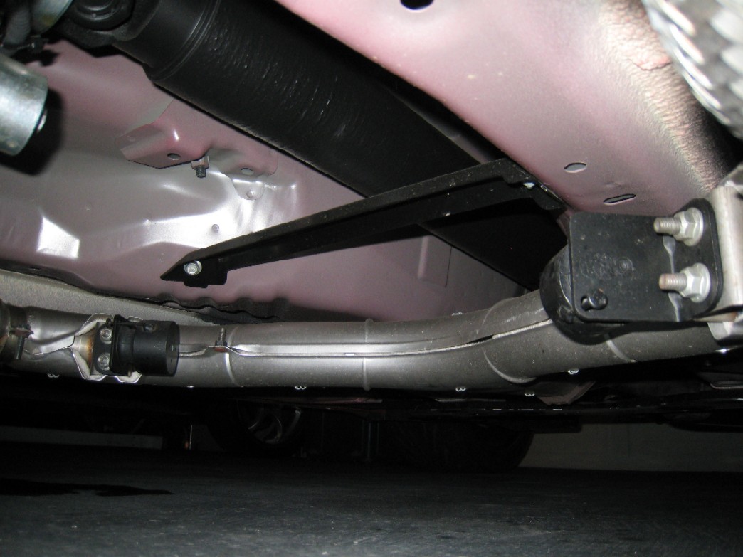

Here I took a pic for you. Two vibration isolators and you notice the Y is straight until the mid pipe then joins just before going into the mid pipe. Much smoother flow.

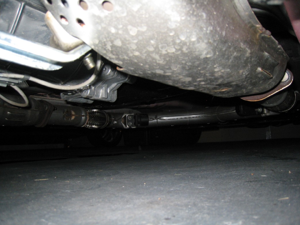

Here is another looking back from the CAT

what do the vibration isolators do? how does it work? I wonder if it would be worthwhile to put them onto an aftermarket exhaust if it reduces any vibrating.
It works by counter balancing the vibration. It would be to much work to weld them on an after market exhaust. The rubber is weighted and suspended off of the bracket. When they vibrate the rubber shakes at a different speed than the exhaust so they balance out or delete every other vibration. = smoother.
