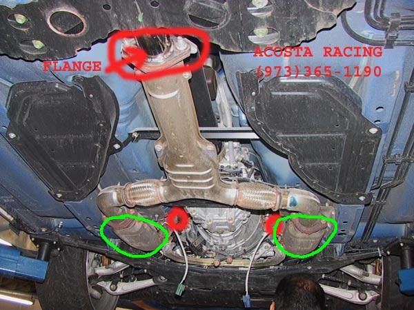

There was a picture that I searched for in the Acosta racing post about their y pipe. They are removed now.
The picture clearly showed 4 cats. The two you can see when you look under the car and two angled down just aft of the headers.
They are there. You just cant see them.

Okay,
First 2 are noted by the green circles.
second 2 you canot see because they are in front of the first 2 just behind the headers.

there are a total of 4 cats, isn't that a lot?
Naw, it is just environmentally friendly. The second cat allows the first cat to warm up faster and also traps emissions that pass through the first cat when cold. The O2 sensor is between the two and thus gets readings after the first.
