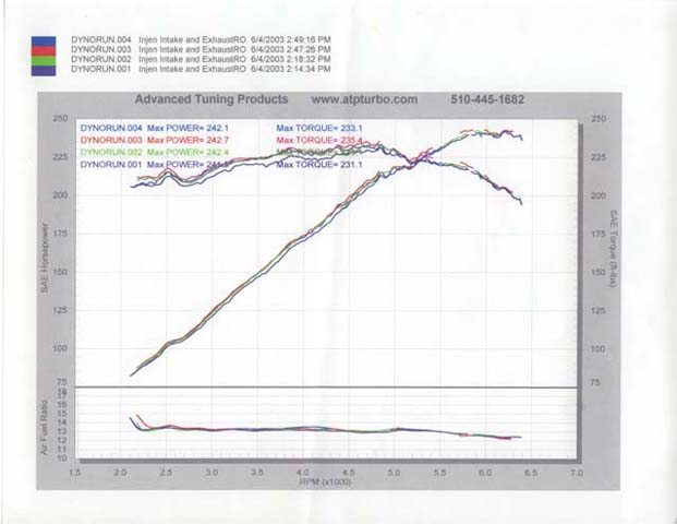

OK guys I had a chance to swing by ATP in Fremont during lunch and get some dyno pulls. Thanks to Yuichi of Strictly Z for coordinating the dyno pull and thanks to ATP for the use of their dyno.

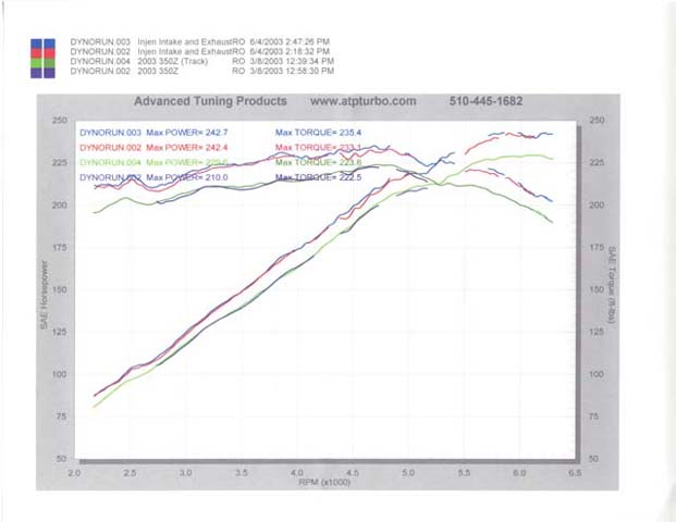

Unfortunately, I was on my lunch hour and didn't have time to get a baseline. There were some stock 350Z guys who did some pulls in March and the best stock baseline is what we for comparison. Best stock was: Max Power: 229.6 and Max Torque 223.8. These March pulls were done in 70 F degree weather. I know this is not a true baseline of my car but it's something to use as a comparison. I'll try and get a baseline of my car later in the month when I have time to pull the exhaust and intake out. Until then I have the "after" results only.
Location: Advanced Tuning Products- Fremont, CA
Dyno Type: DynoJet
Tempurature: 88 F degrees
350Z type: Performance
Mods: Injen CAI, Injen SES, Grounding kit (not that it matters but worth mentioning)
DynoRun 1 - 6/4/03 2:14 PM
MaxPOWER- 241.5 MaxTORQUE- 231.1
DynoRun 2 - 6/4/03 2:18 PM
MaxPOWER- 242.4 MaxTORQUE- 233.1
We were curious so we connected battery for 15 minutes (probably not long enough, but were pressed for time) and did two more runs.
DynoRun 3 - 6/4/03 2:47 PM
MaxPOWER- 242.7 MaxTORQUE- 235.4
DynoRun 4 - 6/4/03 2:49 PM
MaxPOWER- 242.1 MaxTORQUE- 233.1
I'm at work right now but will scan the results and post once I get home.
I was honestly expecting to be about 247-248 rwhp. However I've put about 250-300 miles since the exhaust was installed and the battery was disconnected. I'm not sure if the ECU any effect on the mods yet or not. This "ECU correcting or not correcting mods" issue is driving me crazy.
I'll be going back in next week and doing a few more pulls. I'm doing a pretty significant modification to my car this weekend and will post the results next week.
-Jason

Dyno #1- All four of these are my pulls.
Attached Thumbnails Injen Dyno: results inside-dyno2.jpg
Old Jun 4, 2003 | 10:53 PM
failsafe's Avatar
failsafe
....for your health
Posts: 5,592
From: Raider Nation
Dyno #2- Top two are mine. Green (third from top) is the comparitive run. Ignore the purple (fourth from top) this was an aborted run from another 350 thus the 210 hp rating (don't know why he included this run on the chart ).
Attached Thumbnails Injen Dyno: results inside-dyno1.jpg

Seems to be running leaner (than other stk dyno pulls) throughtout most of the powerband.
