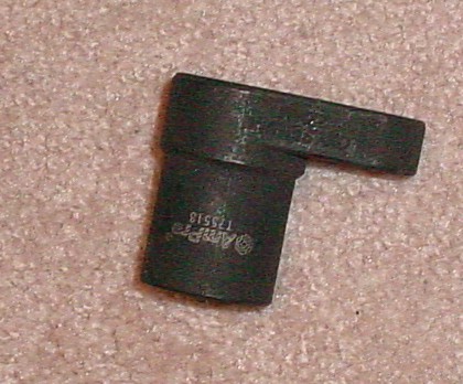

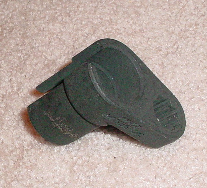

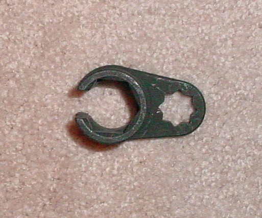

Originally Posted by davidv
Use a wrench like this. See the cut out on the side?
+1... I have one of these... Worth their weight in gold... I got mine at Advanced Auto Parts for like 7 or 8 bucks.
Attached Thumbnails Any DIY on installing Test Pipes?-dsc02189.jpg   Any DIY on installing Test Pipes?-dsc02191.jpg   Any DIY on installing Test Pipes?-dsc02192.jpg
