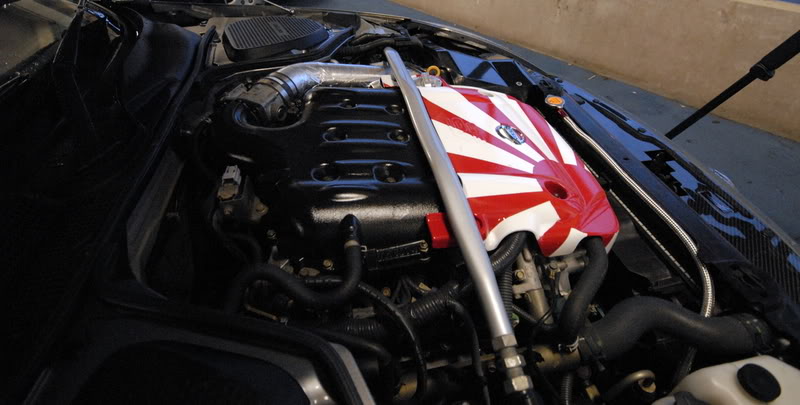

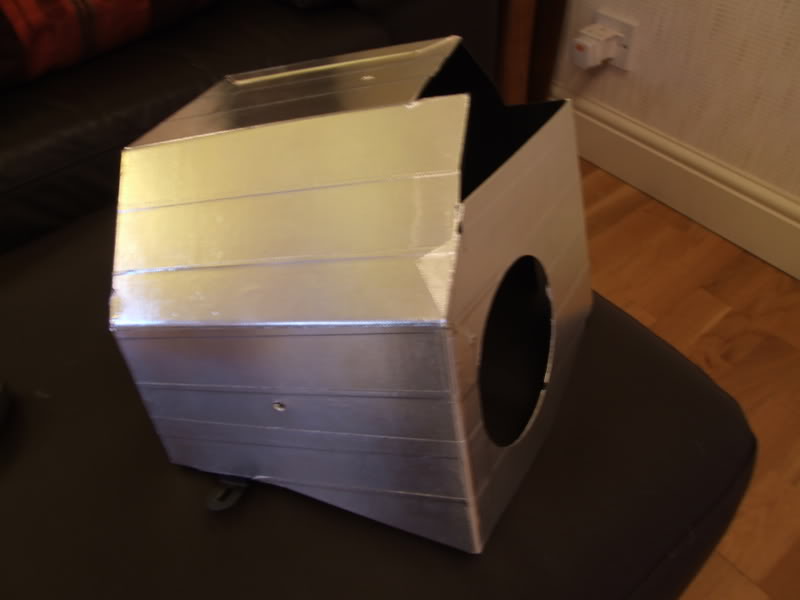

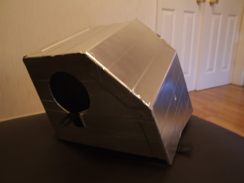

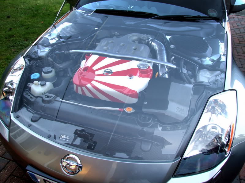

I have heat rapped my K&N typhoon with DEA heat reflect tape!
Did the intake tube and all the air box.
Before after driving i could not keep my hand on the air box and the intake tube was realy hot to.
Now after the heat rap its only just warm! result! lol..
Airbox
Intake tube. Its the best pic i have sorry.
Go for it mate!

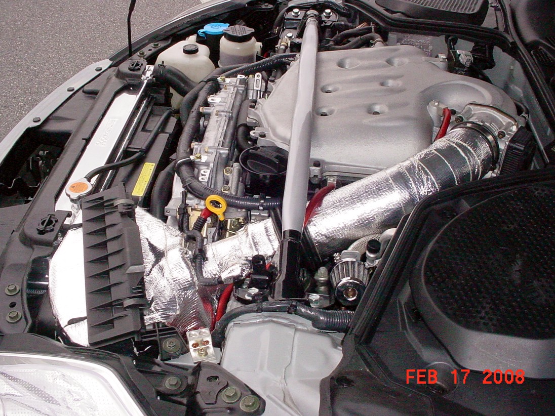

Just wrapped my intake and air box. After watching IATs before and after the mod with Cipher, I noticed no appreciable difference in intake temps while the car was moving above 30mph.
However, while stopped at a trafficic light or being stuck behind some slow-@ss grandma in a minivan, I noticed my AITs were 15C to 20C cooler with the intake & airbox wrapped!
A cool inexpensive mod. :-)
Attached Thumbnails Heat Wrap/ insulate the intake tube?-dsc02270.jpg   Heat Wrap/ insulate the intake tube?-dsc02271.jpg   Heat Wrap/ insulate the intake tube?-dsc02272.jpg

^^Sweet. Looks like u did a good job with it too!

Thanks Jonny! The air box was a little awkward to wrap cause of all the odd shaped corners and such... But it's really no harder than wrapping x-mas presents~ Lol! :-)
