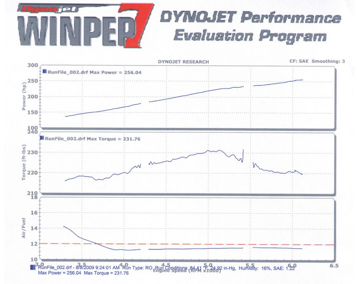

Here is a slightly better dyno pull on the HKS filter:
So here we have 256whp and 232wtq. However the hp curve stops about 6200rpm thus probably hasn't hit the maximum. If you compare against the stock filter graph, it also is pretty darn close to 250hp at 6000RPM and peaks out at 262hp around 6500rpm. So, I think the hp curves would probably be about the same. Unfortunately there isn't enough information to readily compare torque values at a given RPM.
To make it easy to remember values, I'm going with 260whp and 230wtq, which seems to be in line with another Nismo results (http://www.350z- tech .com/forums/in...6&#entry547416 and https://my350z.com/forum/nismo-350z/...yne-gamma.html )
So, overall it's hard to say with any authority that the HKS performs significantly better than the stock filters with this data. Taken at face value, a +/- 5 hp or tq, you are talking about a 2% difference which probably doesn't exceed the %error for most dynos.
One factor that was offered was that since the HKS was dropped in and immediately pulled on the dyno, that the ECU wouldn't be optimized for the new "more theoretically efficient" filter. Does this seems plausible? Or is there no "optimization" period and the ECU and sensors just go about their business regardless? ECU reset necessary? New tune? Any other theories out there?
I'm still curious about if the extra $20 for HKS really does buy extra performance, but will have to wait for another set of dyno runs that hopefully provide more complete and conclusive data.
Sorry, no concrete answers, but a little more data on the topic.

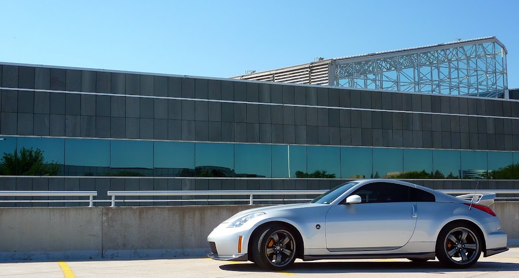

A tasteful shot of the test subject
