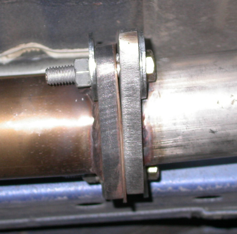

I finished installing one fo the LSD test pipes and fired it up to make sure it was sealed and not leaking at the flanges.
I could hear some leaking and when I put my hand near the joint I could feel exhaust gas coming from it.
I torqued the bolts to proper torque. So then I look closer at the other one which I had yet to install.
Check the rear flange.... it's bent. bent about 1/16" on each end.
hey... LSD you reading this??? what gives?? is this how it is supposed to be?

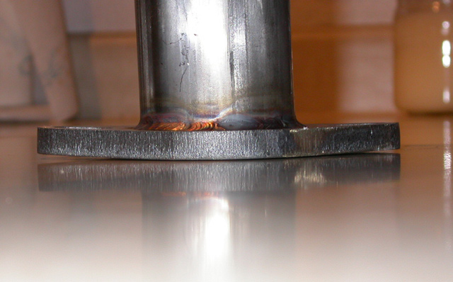

another showing the flange on a flat surface.

No, thats not how it is supposed to be. It looks like my welder got a little crazy with the TIG and cranked up the amps. I apologize, please email me or PM me and I will take care of it right away.
Sorry!!
If anyone else has any problems, please don't hesitate to let me know.
