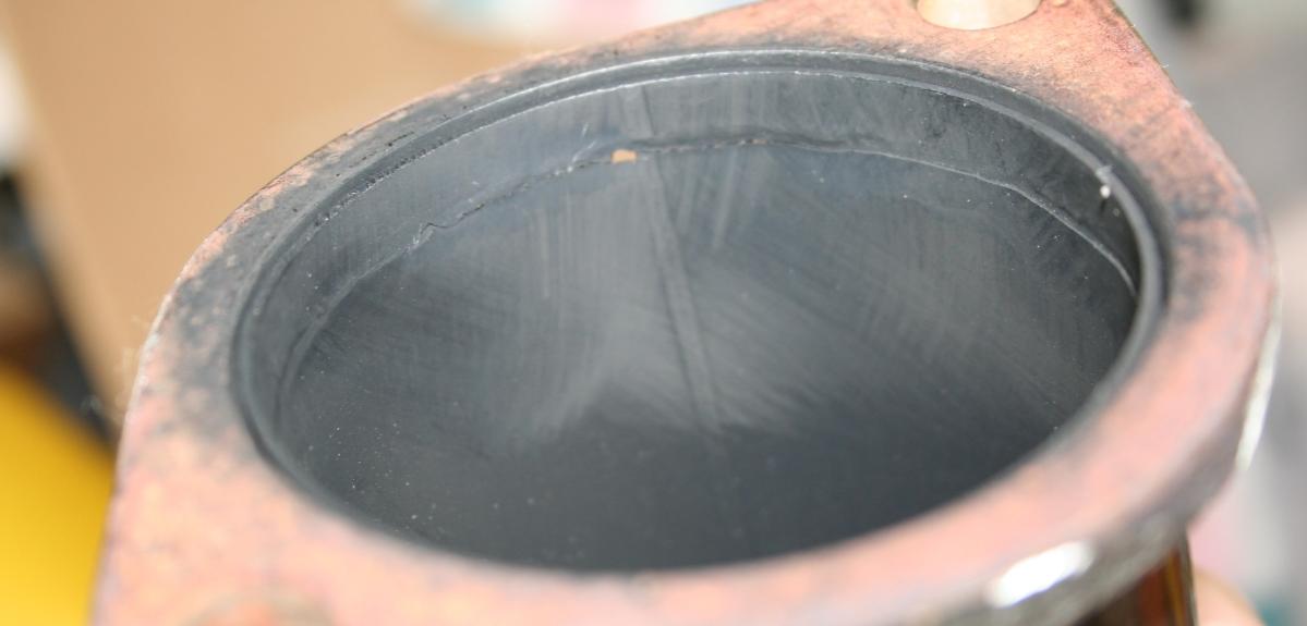

So last week I had my car up on a lift and found that my Nismo S-tune Exhaust has a crack around the Midpipe flange. You know the flange that meets the Y-pipe. I have never heard of a Nismo Exhaust cracking around the Midpipe flange. Everyone I have seen has been cracked at the Y-pipe flange.
Never the less I got it off and removed the supports that are welded to the flange. I will be heading to the welder in the morning.
Pic's.

Originally Posted by _ink
Good spotting! What made you check though?
When I start the car I let it run a bit before leaving. So it made small wet spot on the garage floor due to the humidity. At first I thought it was a gasket, but once up the rack, it was clear it was not a gasket.

I would imagine this huge scrape is the reason why it cracked?
What did you bottom out on?
That's not a huge scrap from bottom out. That's where I grinded off the one of the two support gussets that where welded to the flange so the welder could weld around the whole flange.
