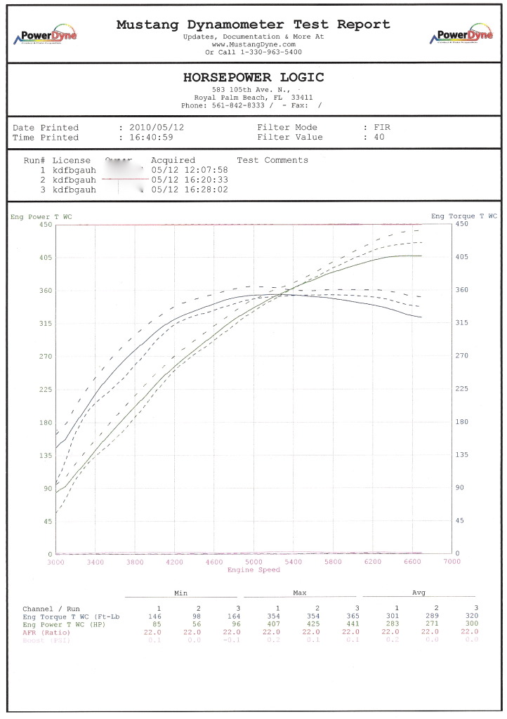

Dynos:
Mods: GTM Stage II TT Kit, 3inch Downpipes, Snow Performance Stage II Meth kit
Key:
[ - ]Run 1 is with the APS 2.5 TD with no meth
[ ---- ]Run 2 is with the Motordyne TDX with no meth
[ - - - ]Run 3 is with the TDX and Meth
Attached Thumbnails Motordyne Full 3in. V1 TDX Dynos, Pics, Vid-sc006405a0.jpg
