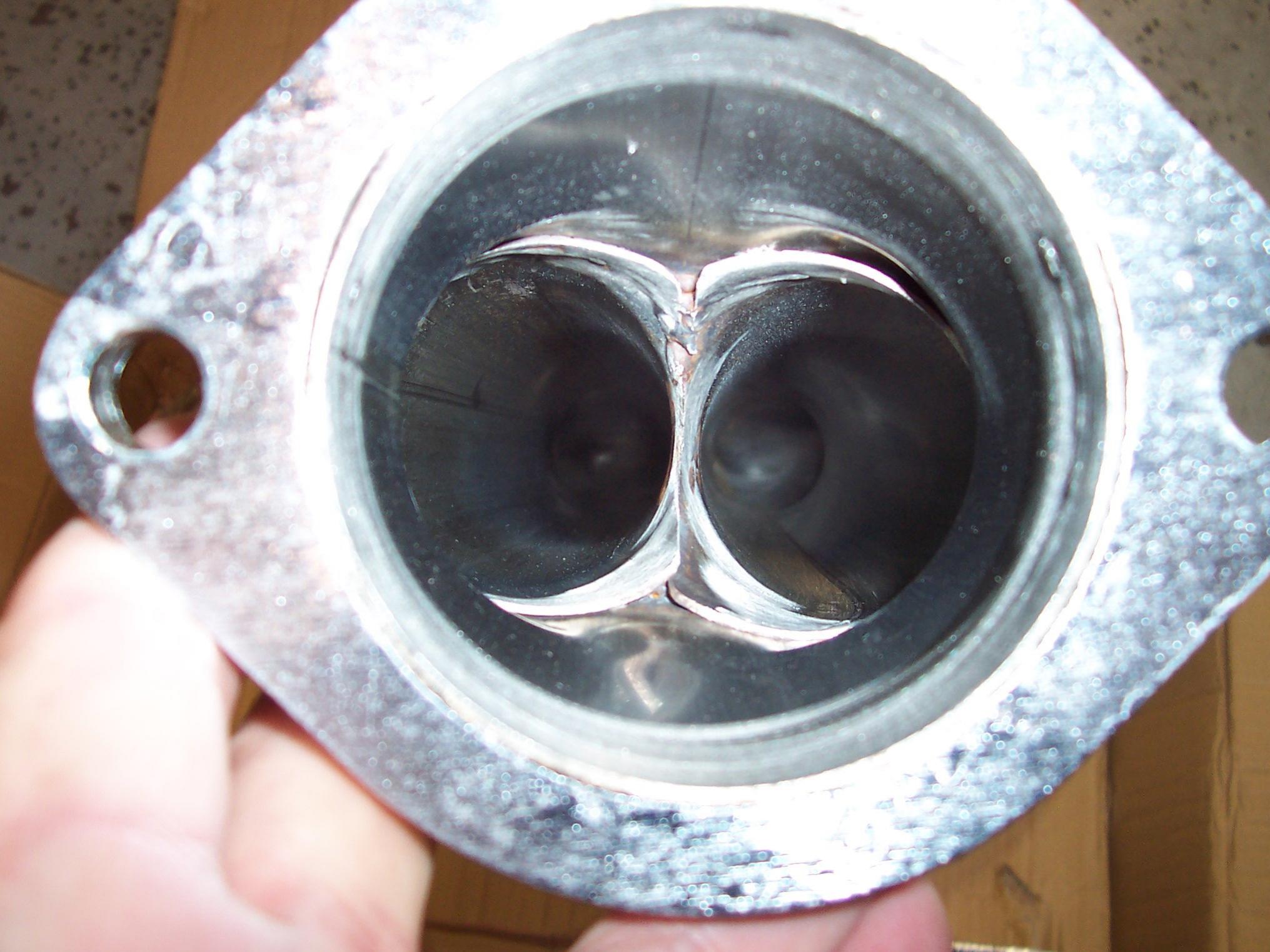

May be old news for some or not that big a deal for some, but I thought I'd share a bit about a purchase & install I made. As posted on another section, I ordered a set of M2 test pipes & an M2 y-pipe from Marinelli Motorsports (vendor here). After going thru several average priced hi-flos & test pipes, I decided to go a little less expensive this time & see what happens. I don't know if I should post the prices here since we have to PM m-motorsports for the prices, but I will say the test pipes & y-pipe were under $200 total...shipping included - quite a bit less than what I have paid in the past!!
Anyway, I installed the pipes tonight - fit was perfect. I ran the test pipes & the y-pipe into my Nismo exhaust I've run for the past 6+ years. Although this M2 y-pipe is almost an exact match to the Nismo y-pipe, it does sit a bit higher at the collector end thereby not pulling down on the cat pipes like my original Nismo y-pipe did & cracked multiple sets of HFC's. Of course, the rasp is there while putting your foot into it for those curious. With the Crawford headers into straight pipes into a Nismo exhaust, the sound is pretty raw & wild at WOT- a sound that I've been used to for years so no biggie. As before, at idle it is pretty quiet.
Anyway, just wanted to inform a few people if you're looking for an inexpensive setup. Time will tell how these pieces perform as per cracking, etc. I'll update if need be. Until then, I'm quite happy with the fit during install, the welds, the collector on the y-pipe (a little sloppier inside than the Nismo y-pipe, about the same that I've seen on several others I've run and/or helped install in the past). Here's a few shots of the packaging, the welds, the inside of the collector and the installed look. Hope this helps any of you. Oh, the inside diameter of the test pipes are 2.25" & the collector end of the y-pipe is 3.00". They also came with all hardware & gaskets.

I got the megan racing one, the vendor told me that it was a little better than the m2, for an extra $10. Haven't been able to install it. Wasn't able to remove the old nismo y-pipe, need to take it to the shop, but here are some pictures if the op doesn't mind, i'll remove them if he does:
