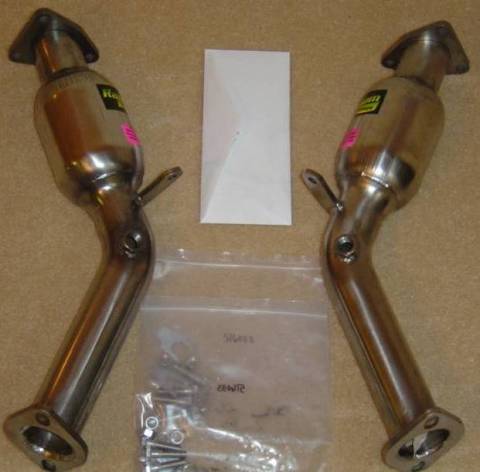

1. I think the RT are the best
2. 500 at performance nissan if you metion my350z member
3. performance nissan
4. about 2 hrs
5. should pass smog (check you country for regulations)
6. 5-10rwhp
and here is a pic of what mine came with.
