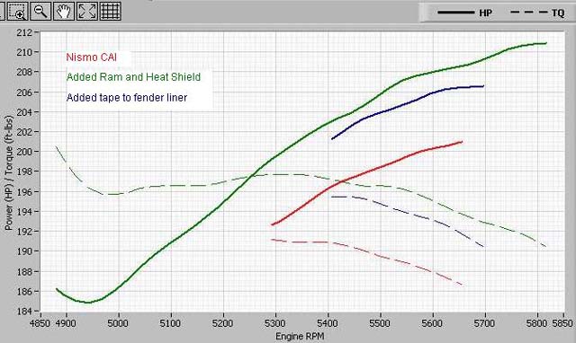

Here's what the G-tech Pro Competition had to say about all of these little mods. The red is stock + Nismo CAI only. The green is the addition of the ram and heat shield, and the blue is with the fender liner holes blocked.
Not shown is the speed in this comparison, which is approx. 35-40 mph. Further up the graph, above 50 mph, the blue line crosses above the green until at peak HP, in 4th gear at about 85 mph, I got over 3 RWHP increase with the vents blocked.
Originally posted by zxsaint
Why is the rwhp showing up so low? It should be at least 20-30 more.
I was waiting for someone to ask that. Good question.
Part of the reason that the number seems low is that the car is moving, therefore incurring drag. In this respect, the G-tech is a better guage of a car's overall performance than a dyno.
The second reason for the low numbers is that for these runs I put in the gross vehicle weight - and did not add weight of the fuel or my fat a$$.
I have another series of numbers with the weights adjusted, but I didn't have the third (blue) run (the landfill was closed on Sunday) so it it would not have been complete for the illustration I was trying to make.

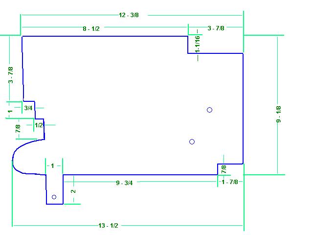

Next, I created a template for the new ram out of heavy card stock. It took a while, pasting bits and pieces together, then transfering the final design to a clean sheet, but here's the final template.
Thanks everyone for all of the positive feedback.
I'm making two more of these for guys on the forum that want them. While I'm at it does anyone else want this kit? I'm asking $70 for the ram and $50 for the heat shield (or both for $110) plus shipping.
