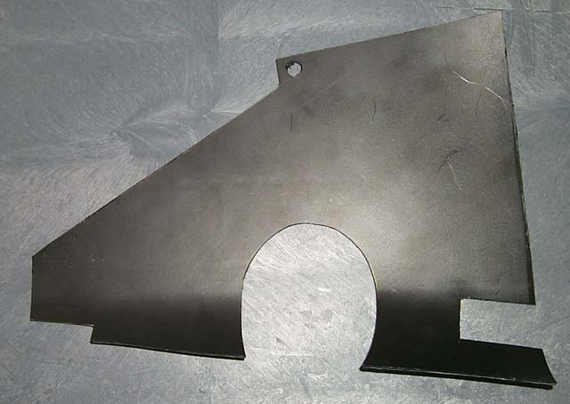

Next, I created a template for the new ram out of heavy card stock. It took a while, pasting bits and pieces together, then transfering the final design to a clean sheet, but here's the final template.

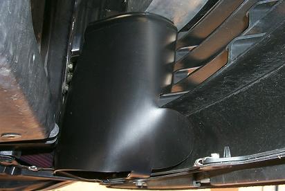

Then I went looking for some heavy vinyl stock. As I was giving up after visiting 3 hobby shops and a few home improvement centers, I walked past the perfect substitute - a black vinyl trash can . The cost, $2.65. Perfect.
I used the curves and contours of the trash can where I would have had to bend the stock vinyl anyway, and used the bottom of the can instead of the upper tab you see in the template. Here's the final product uninstalled.

And this view is straight up from the bottom where you can see the real shape of how the air flows.
I used all existing mount points and fasteners left over from the inner panels that I removed in the first place.
Can I tell a difference in the butt dyno? No, but my G-Force Pro Comp. tells me that I'm seeing a 6.5 RWHP gain where Nismo only claims 5.5 RWHP.

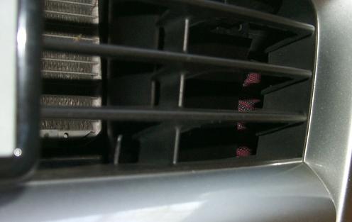

No, it channels air from the front grill.
The bottom edge matches up to the engine cover pan. Here's a picture of it from the front. You can't really see anything, but that's the point, it looks like it's a stock part.
Attached Thumbnails Ram for AEM/Nismo CAI-ram-for-cai-front-1.jpg

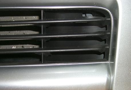

and from this angle, you can just make out some of the filter cone back in the bumper cover cavity.
Attached Thumbnails Ram for AEM/Nismo CAI-ram-for-cai-front-2.jpg

Take a look at the template shown above. The left edge is what curves around facing forward, butting up behind the vertical slat in the bumper cover. The funny looking oblong in the lower left of the template fits into the center portion of the bumper cover below the grill.

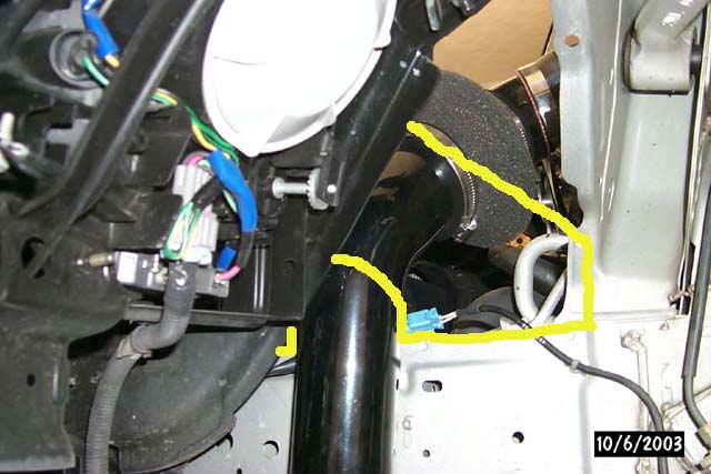

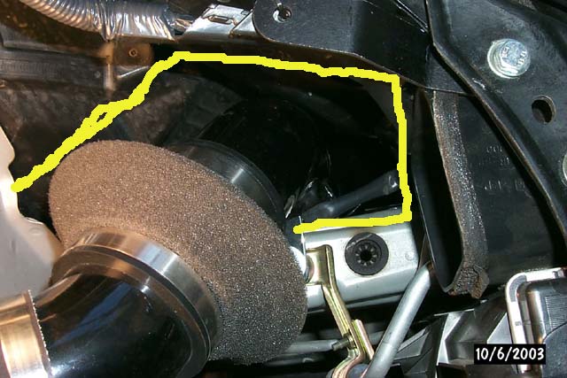

OK, as I promised and as requested, here are some pics of the heat shield, the fender liner taping, and results from testing with the G-Tech Pro Competition.
The cavity that the heat shield is going to block...
Attached Thumbnails Ram for AEM/Nismo CAI-heat-shield-outside-showing-outline.jpg

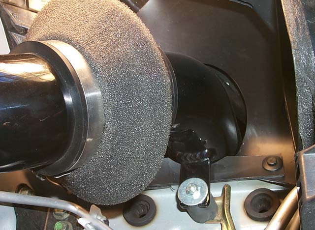

Posts: 628
From: Va Beach
and from the inside...
Attached Thumbnails Ram for AEM/Nismo CAI-heat-shield-inside-showing-outline.jpg

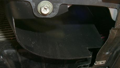

The shield itself not installed
Attached Thumbnails Ram for AEM/Nismo CAI-heat-shield.jpg

Sorry, but this is the best pic I can make. This mat black polyeurathane (LDPE) just doesn't show up for the camera. I like the fact that it blends in with the stock materials myself.
Attached Thumbnails Ram for AEM/Nismo CAI-heat-shield-installed.jpg

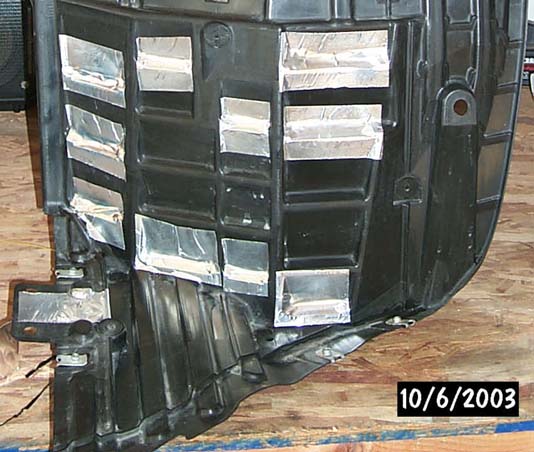

Here's a mod I took out. Basically, I taped up all the vent holes in the fender liner with aluminum tape. At speed this creates a bit of positive pressure in the filter cavity thus more air to the throttle body.
Unfortunately for me, this actually lowered my power a bit below 50 mph, so not good for autocrossing. When I get this car on a road coarse (VIR in November I hope) I'll tape this back up. It's easy to do, and fairly easy to remove.
