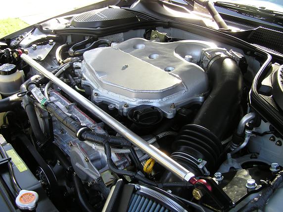

The whole point of the Crawford Plenum is that the stock plenum slopes down in the front to accomodate the hood and the stock strut bar, and therefore squeezed down the area that gets air to the front 2 cylinders. That is the problem that Crawford is resolving by creating more air for those 2 cylinders, with the taller plenum. There is simply no place for the stock strut brace to go. So you get Crawford's brace for $200. It is offset from the shock towers with heavy duty brackets. That is not a perfect solution, but it is about as good as it is going to get. Here's a pic.

Your plenum looks nice, all the welds are nice and neat. I guess i saw some of the earlier ones that welds weren't so neat and made it look like a hack job. I'm glad the quality has gone up.
