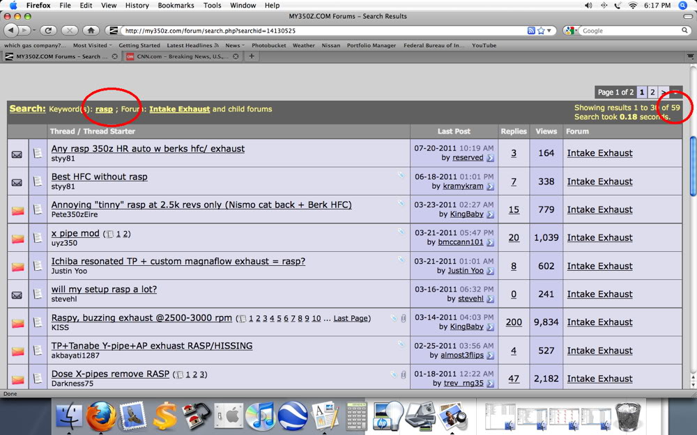

davidv's Avatar
davidv
Posts: 42,753
From: Tucson, AZ
Cool another rasp thread. I hope we can get to the bottom of this.
