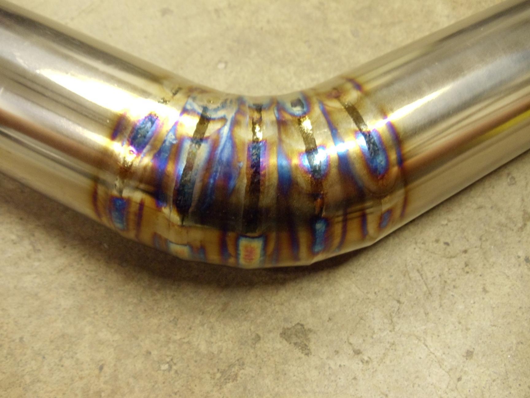

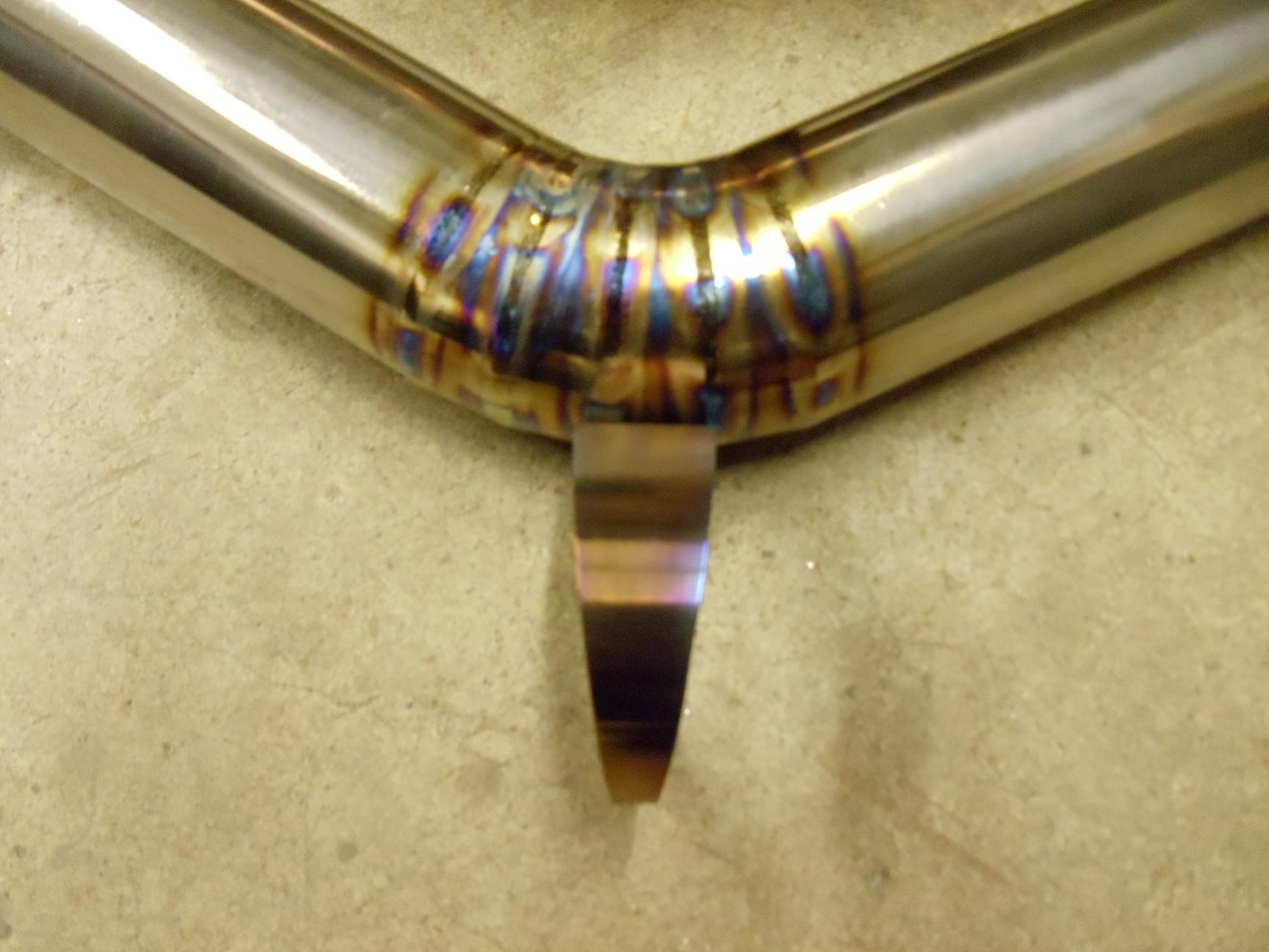

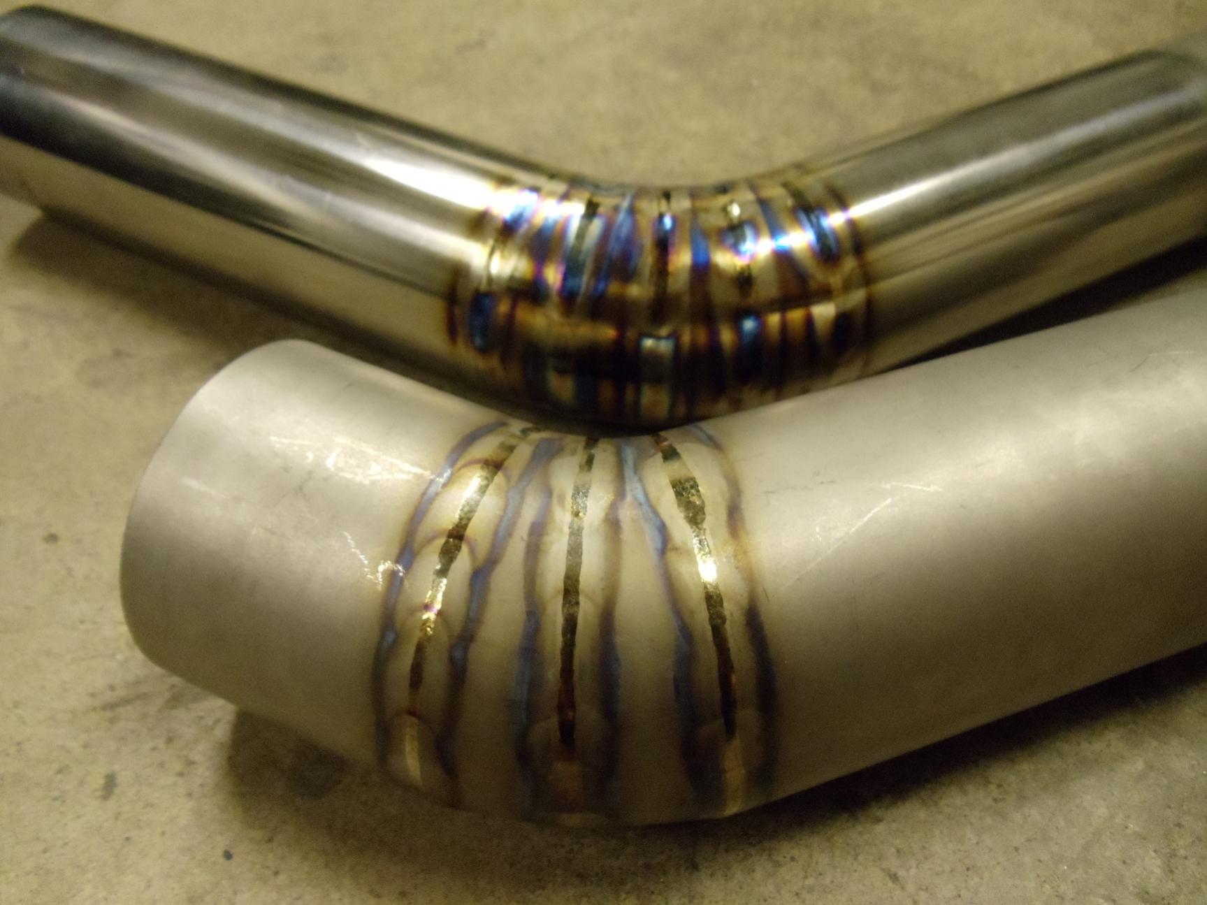

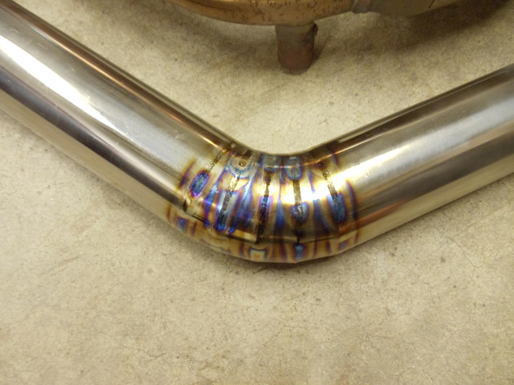

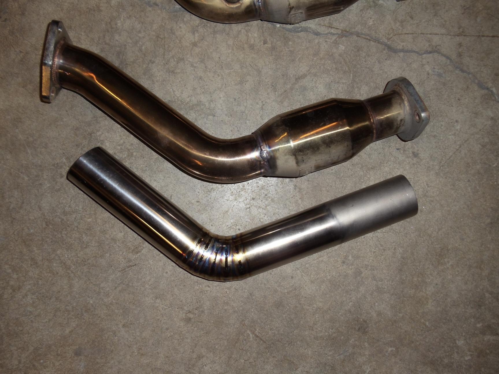

I've been tinkering around with titanium a little more here at work and really just got the feeling of how titanium works and welds. To start out with I am making 2.5" test pipes which will join together later with a 3" y all the way back. Flanges are being water jetted right now so I won't get those in till next week. Each pie is about 15 degrees. The material I used is 16 gauge so it's not quite as light as some pieces I have seen but I will exchange a couple pounds for strength.
The third picture shows a piece I colored by anodizing. I do plan to anodize my test pipes when I am done and I think it will look crazy with the welds.
The last picture shows a 3" piece I welded a few weeks back in raw form. The polished piece was harder to weld due to the arc jumping around
I will have some updates later this week as the Z will be on the lift with test fitting of our stainless version of these pipes.

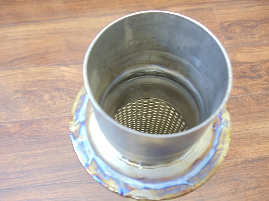

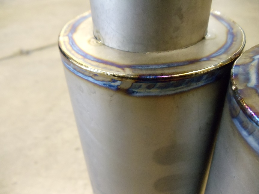

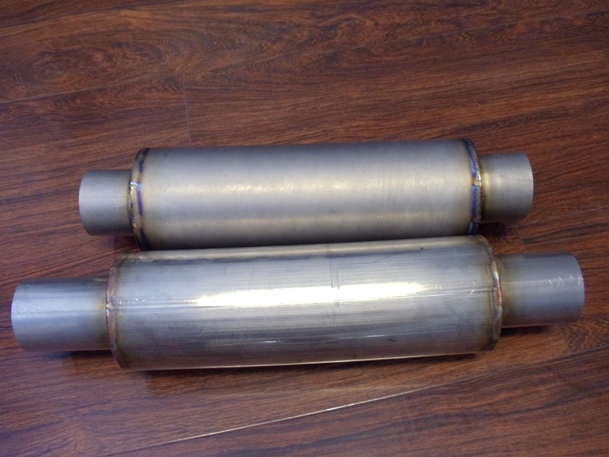

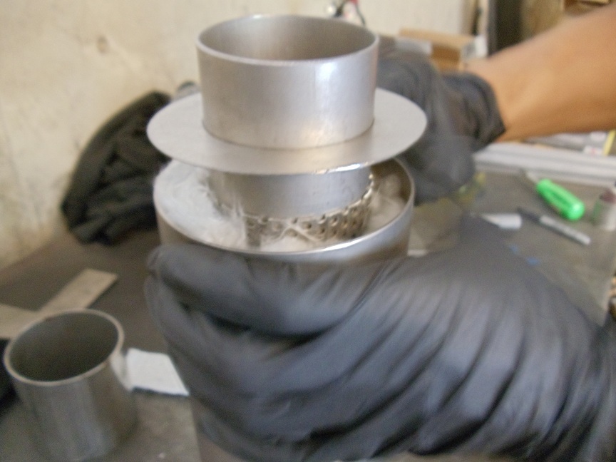

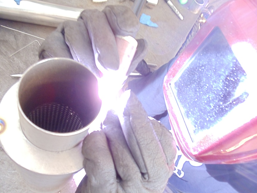

Got a bit of time today to make the resonators. My first titanium muffler so it will be better next time I don't have the actual weight yet but I made the exact same muffler out of stainless and it is significantly lighter. I will put it on a scale sometime next week to see actual weight. I'm also messing around with different packing materials so that will also change the overall weight. I made this muffler with a slip fit joint so it can also be used with stainless piping. Enjoy!!

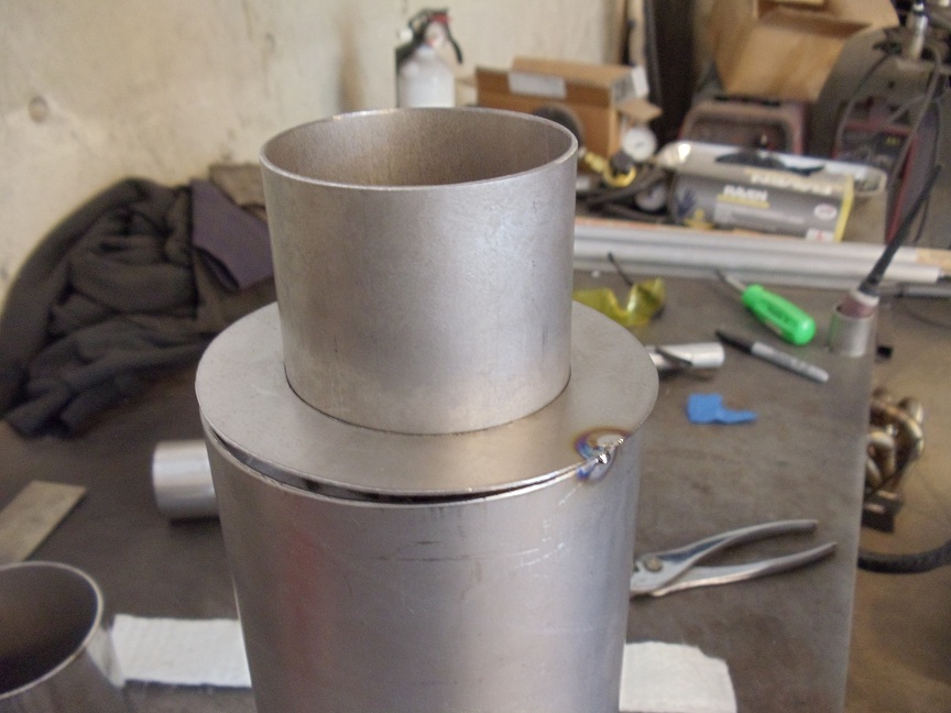

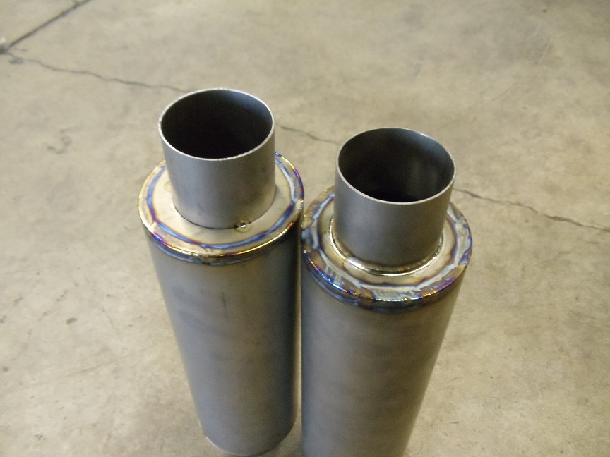

Here is the second muffler I started on...
