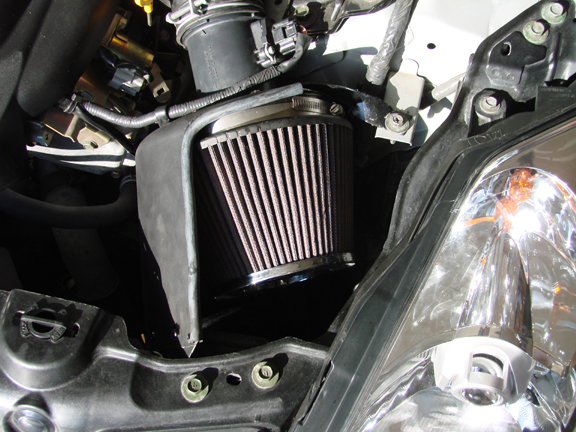

Okay no flaming or laughing if you can help it. Bought the JWT Popcharger from another member but they did not have the heat shield or bracket. So whats a cheap guy like me to do.............make one. Saw a link on google about a guy using a rubbermade garbage can and it looked good, so I started looking around.
Well I found a $1.75 black 12 quart bucket and made it work. I think it came out pretty good and it does what its suppose to do.
Oh okay you can laugh.

it looks good i would never thing of that ive been making a custom box for a friends 03 monte carlo ss with fiberglass and bondo i might scrape it for this

Not bad, OP. Good to see folks trying something different. Do you think it's going to hold up to the engine temps?

Put it to some stop/go city driving to see if there is any wear/melting action!

i figure it was cheap enough if it does not work out, I will get some sheet metal and make another. Thank God Springfield is small enough there is not alot of stop and go traffic, but it does get pretty hot in the summer. Time will tell.

The only thing i would do is extend the top up higher to the hood. If you look at the JWT set up , it does that to get a better seal.

If you want to seal it to the hood take your camera phone and a flash light, turn on the camera in video mode and set it in the engine bay. Slowly lower the hood and then watch the vid to see where you need to add material.

Looks good Bill, glad you got it all put together, honestly looks better then the original setup. If the heat shield holds up I might do the same thing to mine.
