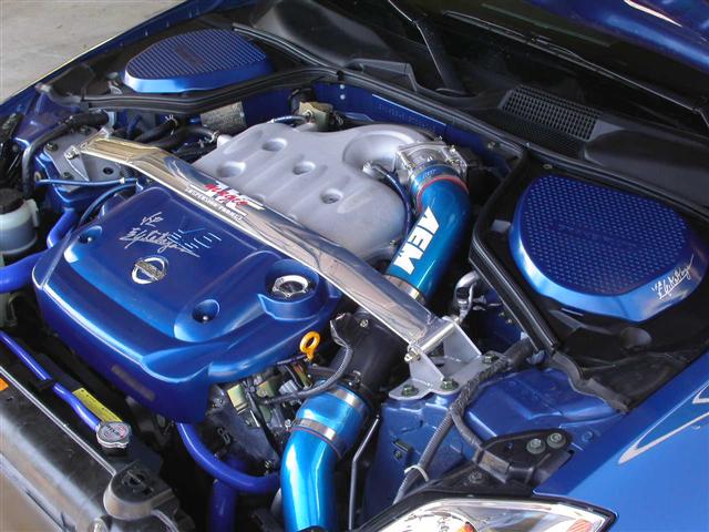

First off Bro, Do not under Estimate our Texas Summers. One of the first mods I did to my Z was a JWT POP Charger ( there wasn't a CAI out of the Z yet in Nov. 02) I loved the increase of low end torque and the Growl. but as soon as the Temp started to rise (over 80) I could REALLY tell that the engine was being heat soaked and loosing HP. So I pulled off the POP and put on the AEM CAI. Major Difference I gained 3hp over the pop Charger but lost 2 lbs of torque. After having both, The pop Charger is good for the Low end But a CAI is Betteri for the Hi end and over all.
I NEVER open my hood and say, Look at my engine! My engine is a workhorse, not a Prancing Horse
That is Because you Engine Does not Look as good as mine does

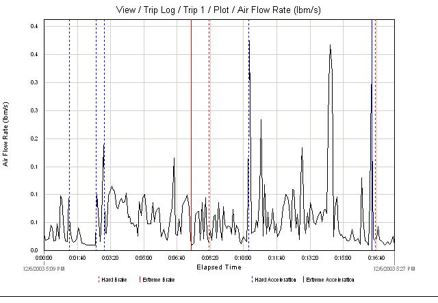

I did a little experiment with the Injen, Nismo, JWT popcharger and stock air induction set ups. Yes I for some unknown reason have three different air inductions products for my Z? I used a chip to read data from my ECU. Specifically I read the intake air temp and flow rate, along with some other data. Here is what I found: The Nismo/AEM, and Injen CAI restrict air flow compared to the stock set-up. However these CAI do result in slightly lower air intake temps, especially after the car is warmed up and has been running for a while. Otherwise, they are restrictive. I tested all three intakes under identical situations right after another. This was a major pain in the Butt to do! Right now I have decided to go with the JWT popcharger. From my test results, it is clear the this setup produces the most air flow and keeps the air cool just as well as the Injen, Nismo & AEM setup. Tonight I added the Crawford Pluenum and my air flow is off the charts! I can definitely feel the increase in HP at higher PRM, especially after 5,500K RPM. I have been meaning to post my techical results for people to stab at and hopefully bring more insight into my experiment, however I need to get a scanner to post soem of the data.
Here is a snapshot of the air flow form the stock setup.
:: Hope everyone can view Bitmaps, becuase this is all I can pst for now.

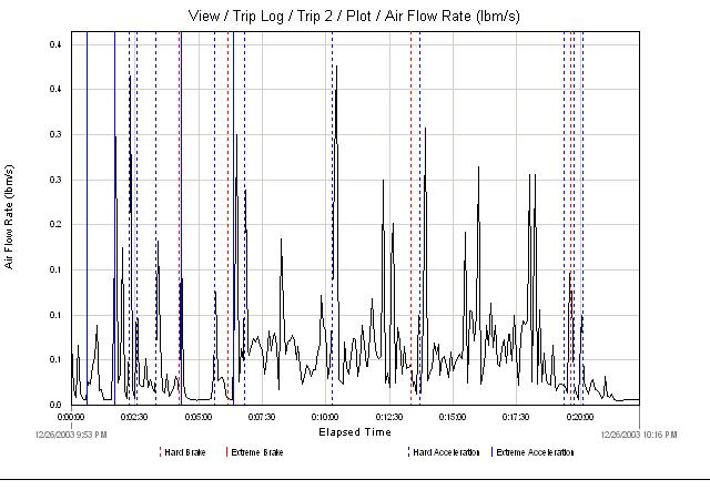

Here is a graph of the Nismo/AEM CAI intake with results for Air flow. I also have air intake temp, etc stats. I have a ton more data than this, but this is all I can figure out how to post at this time. Injen results were slightly better.
All runs were done on a closed track, at the same speeds, the same day, under the same conditions. I made sure the I made every run as identical as possible. These runs show results under all differnet types of conditions, i.e. WOT, hard braking, 100MPH+, etc.
I am not an expert on any of this, nor am I challenging any manufactuer claims, this is just the data that I happended to get from my car, so take it for what its worth.

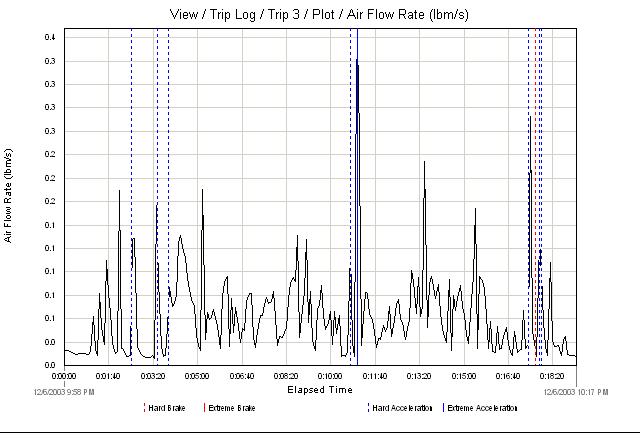

Here is pic with JWT popcahrger and Crawford Plenum.

Could you explain what Air Flow Rate (Ibs/s) is a measurement of?
Looks like pounds of air per second.
