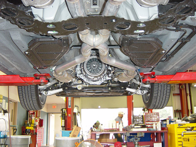

I have the Borla on my G35 coupe, as well as the Borla headers and the Random Technology cats. My sound is slightly impacted by the fact I am putting more throught it with an FI unit.
The supercharger was the first mod. The exhaust note was a bit louder, but not much, on the stock exhaust system.
The headers and catback went on next. There was little change in the sound from the stock, just a little bit deeper, but not really louder. If one were making the change for sound results, it would be a disappointment. If you wanted minimal sound change, you would be thrilled.
The RT cats went next. Significant difference. Tone deepened and mellowed, the header "growl" came out under acceleration, and above the 4000 rpm level it gives a deeper roar. Not obnoxious, very satisfying. I like it a lot.
The Stillen is a heavy unit. It is well built. It sounds great. I wanted to drop the weight, and the Borla was a lot less expensive. The weight, not the money, was important to me in this choice.
HP. Hmmm. Mods are not "additive" in releasing hp. And the order you put them on has an effect too. When I put the headers and cat back on I actually experienced a DROP in hp and torque on my FI engine when I got it dyno tuned that day. That was a puzzler to be sure. And it was running leaner too.
Put the RT cats on next. Big sound improvement, and 20hp+ gain at the rear wheels per the dyno tune. And by the way, running real lean again. Good to get the tune on your a/f and keep it under 4000 rpm until you do.
Why? Possibly it was that the cats were a "bottleneck" at least when you run FI. Possibly it is the ECU, reacting to an O2 sensor read of the increased and cooler flow and impacting the programming. Just be careful if you are running FI and start playing with your "breathing", either intake side or exhaust side, to get yourself tuned up on your a/f and ignition timing so you do not get early detonation and blow a hole in a piston.
Enough safety message.
The Borla is sounding great and I like it very much. The Stillen is a good sounding unit too and the fellas I know that have it are satisfied. A little deeper in tone to my ear. But costs more and weighs more.
Hope that helps. Enjoy it, whatever the choice.
