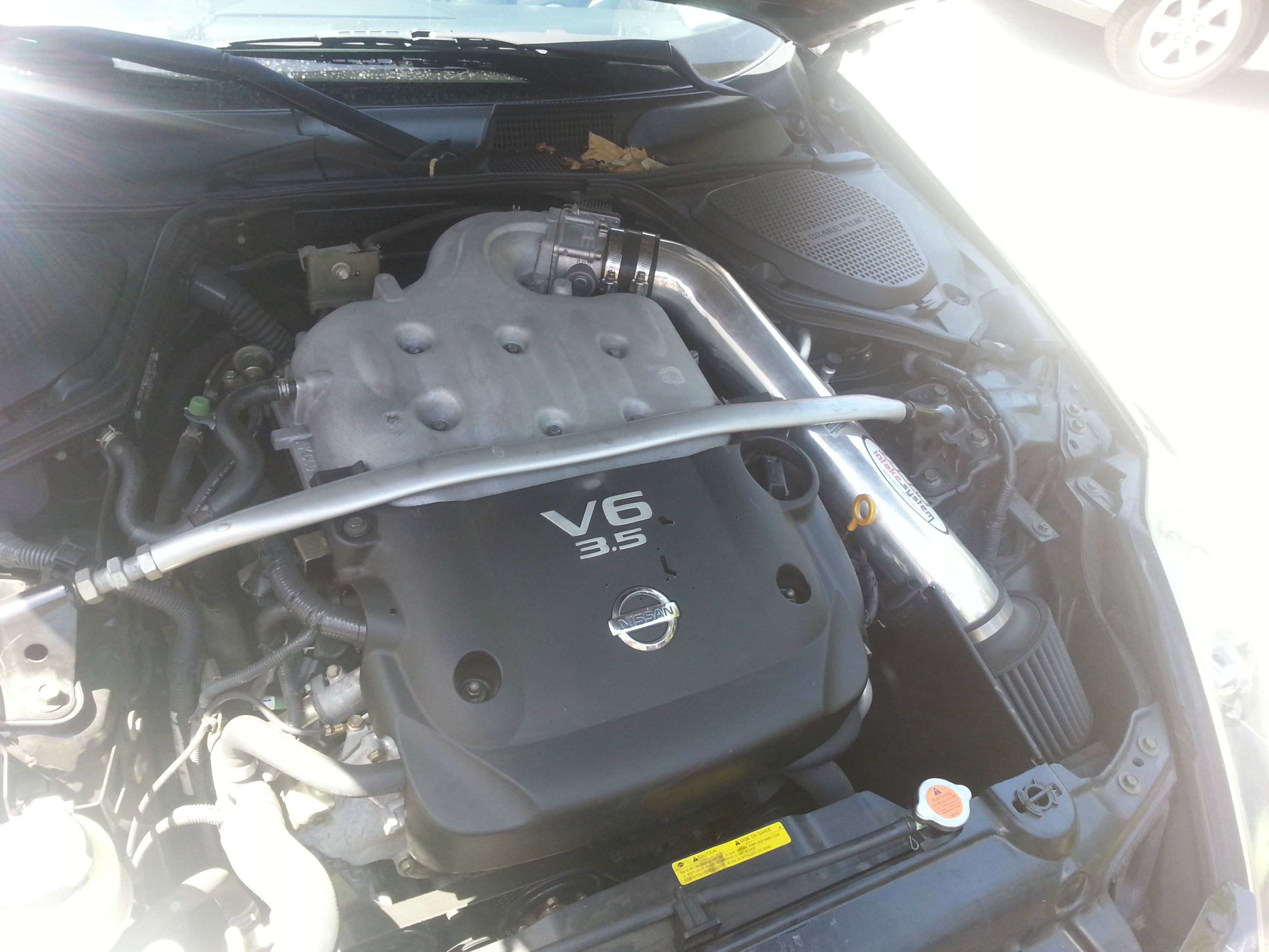

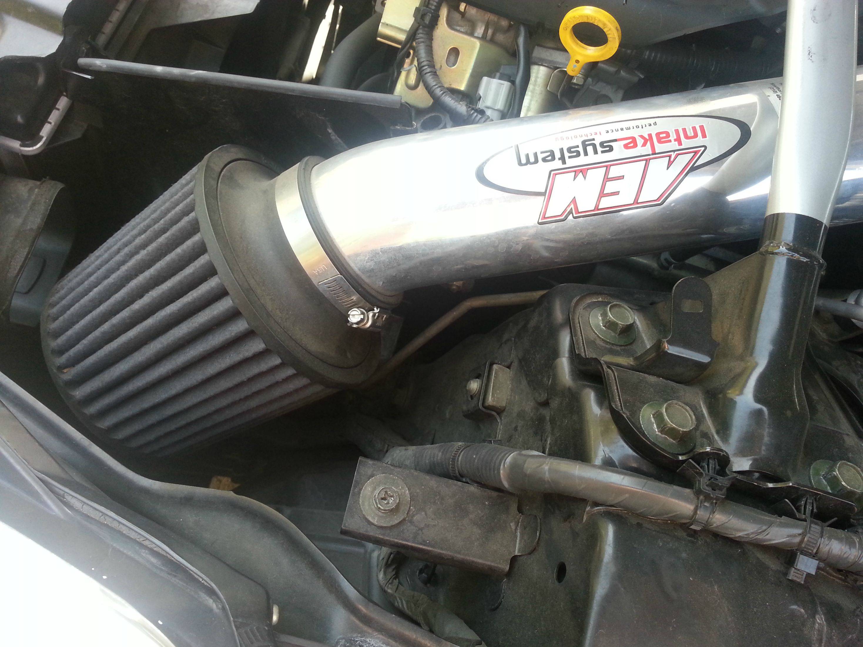

So I just got my 04 Z a couple months ago, ~60k miles, and it has some modifications the person I bought it from wasn't able to identify exactly...there is definitely a plenum spacer, 5/16" I presume because the stock strut bar is still there, and an AEM short ram intake.
The intake tube diameter is larger than the stock size, so I'm wondering if there is some adapter available that will allow me to keep the AEM tube but still install the pop charger. If necessary, I can buy another intake tube...but I just am not seeing diameter denotations when browsing tubes. Would the Z tube, for instance, be an appropriate size / still fit onto the plenum even though it's of a smaller diameter than the one currently installed? What's my best avenue here?

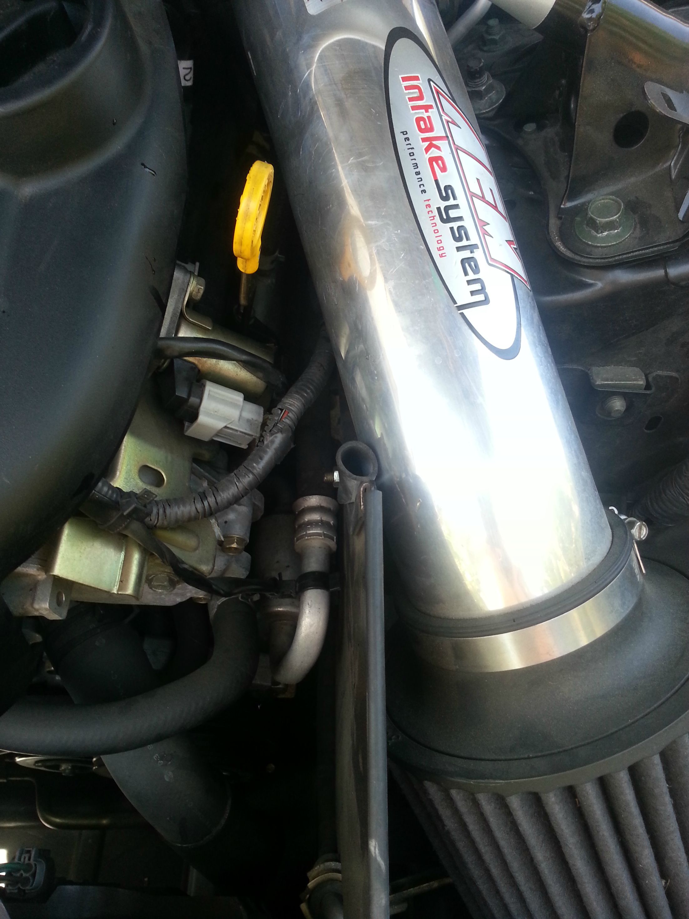

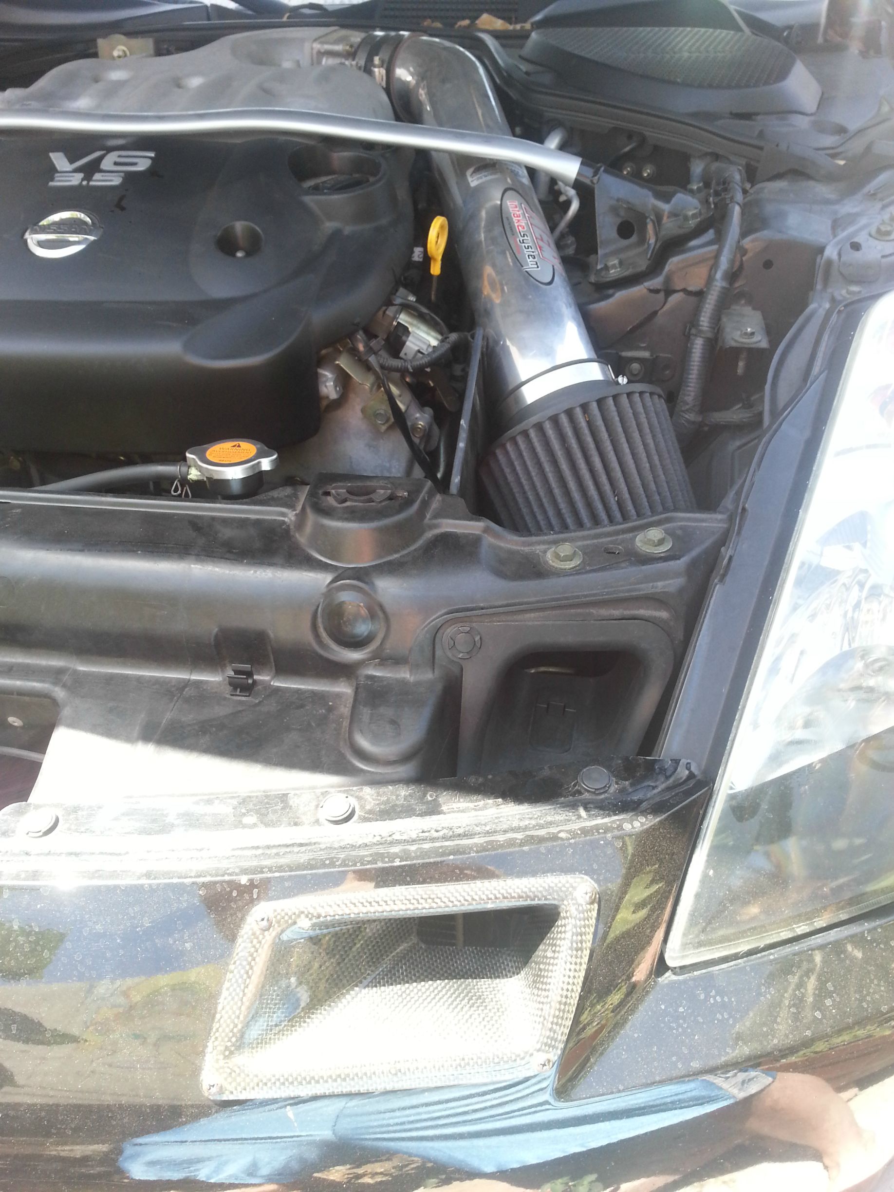

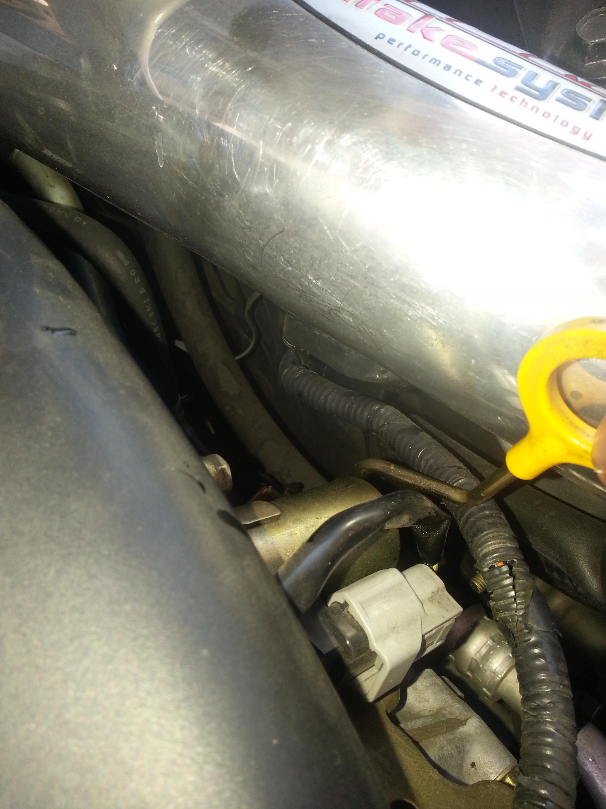

Where's your MAF sensor? Pictures.
I have no idea! Pictures incoming.

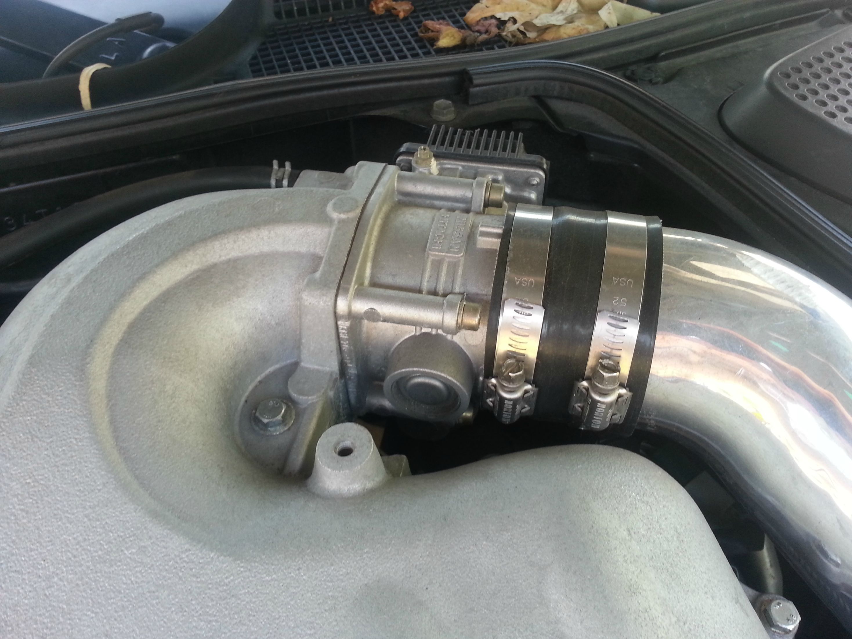

A ZTube from JWT comes with "tubes" that will adapt.
???Where IS your MAF???

Got it, thanks. The MAF is actually connected to the underside of the tube, can't see in the pics but I just verified. So the Z-tube is a good choice? Is there a way to determine which plenum spacer is installed?

You will need more than a Z-tube, you will need the OEM MAF housing as well; which is where the pop charger connects to:
It looks like your filter is washable/reusable (if it's AEM that is) or you can just buy a brand new filter from AEM:
http://www.aemintakes.com/search/pro...x?prod=22-547P

The Z tube connects to the throttle body,not the plenum.
Can you SEE the spacer?You should see a piece of metal
under the plenum sides.You have the stock strut bar.If you have a
spacer,its a 5/16.As already mentioned,if you are installing a Popcharger
(why since you already have a intake?),you will need the OEM MAF housing
to fit the PCGR adaptor/venturi.
Just wondering,how does your car run now?
Filter looks dirty.Clean or replace the filter.
