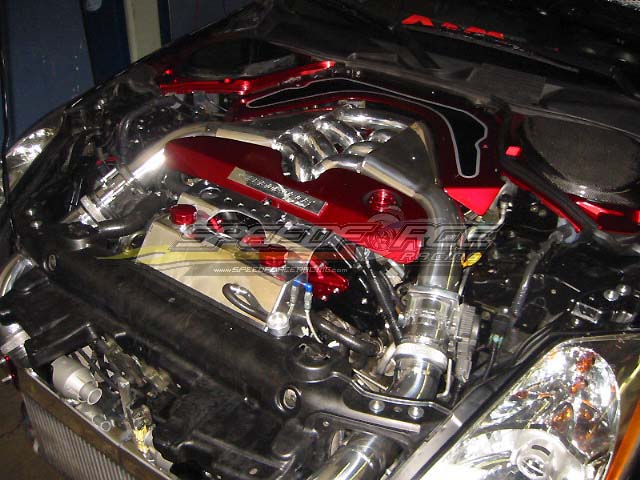

GOD, are ALL the threads turning into pissing matches?? LOl... I can't comment on much but jerry was right about "laminar flow"...It is the same principle at work inside a patients endotracheal tube/anesthesia breathing circuit...the layer next to the hard surface provides "air suspension" of sorts so that the air ON TOP of that layer, flows better......kinda like a buffer zone to keep the turbulence contained and not influencing the main air flow...Don't know about fuel in suspension, where it is etc etc...Tim at SFR does a dual TB on the 350, along with a plenum for the person asking earlier...Don't know the specifics but he's a call away...(c-website speedforceracing.com).
http://www.speedforceracing.com/index.php?productID=849
