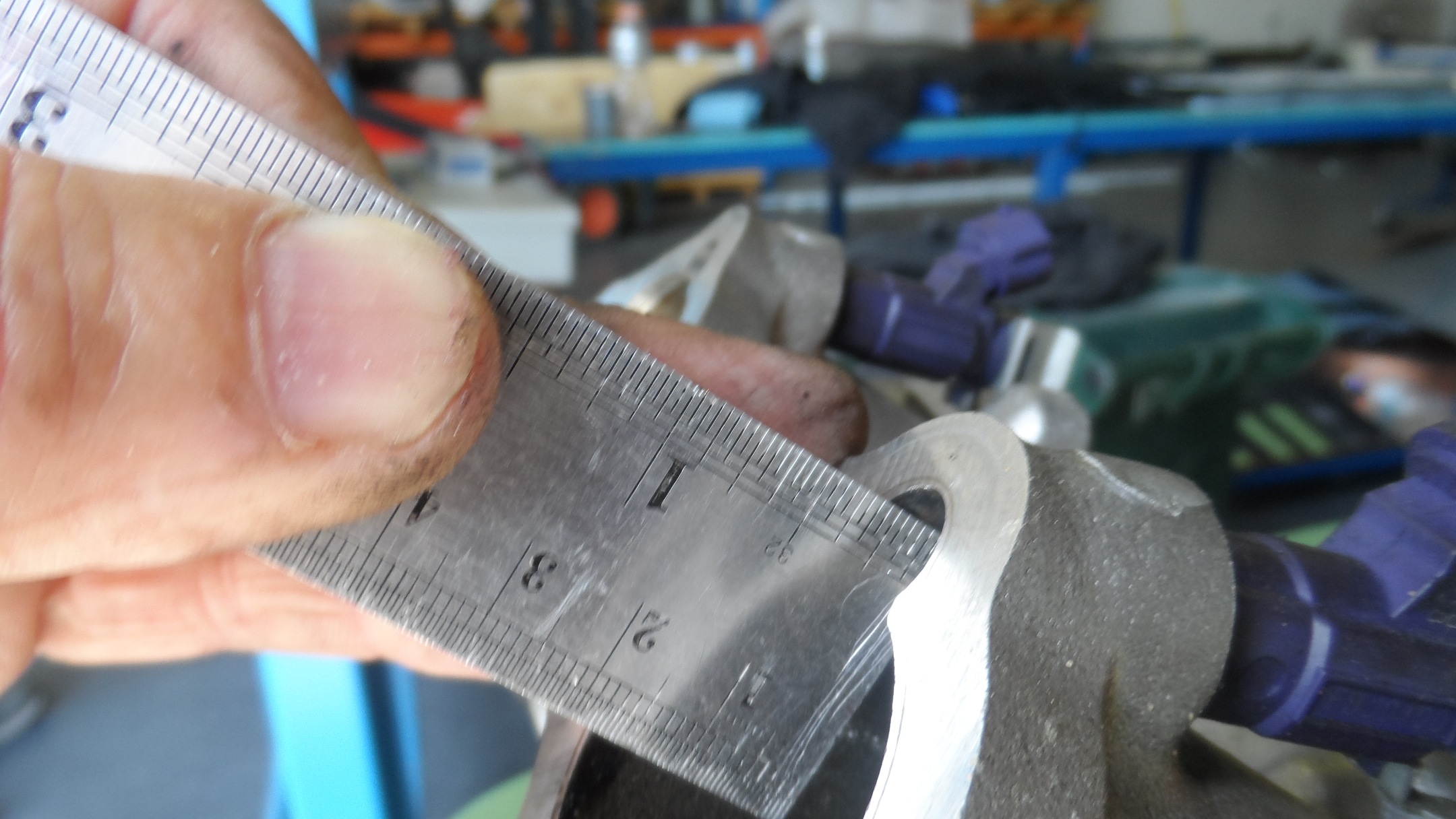

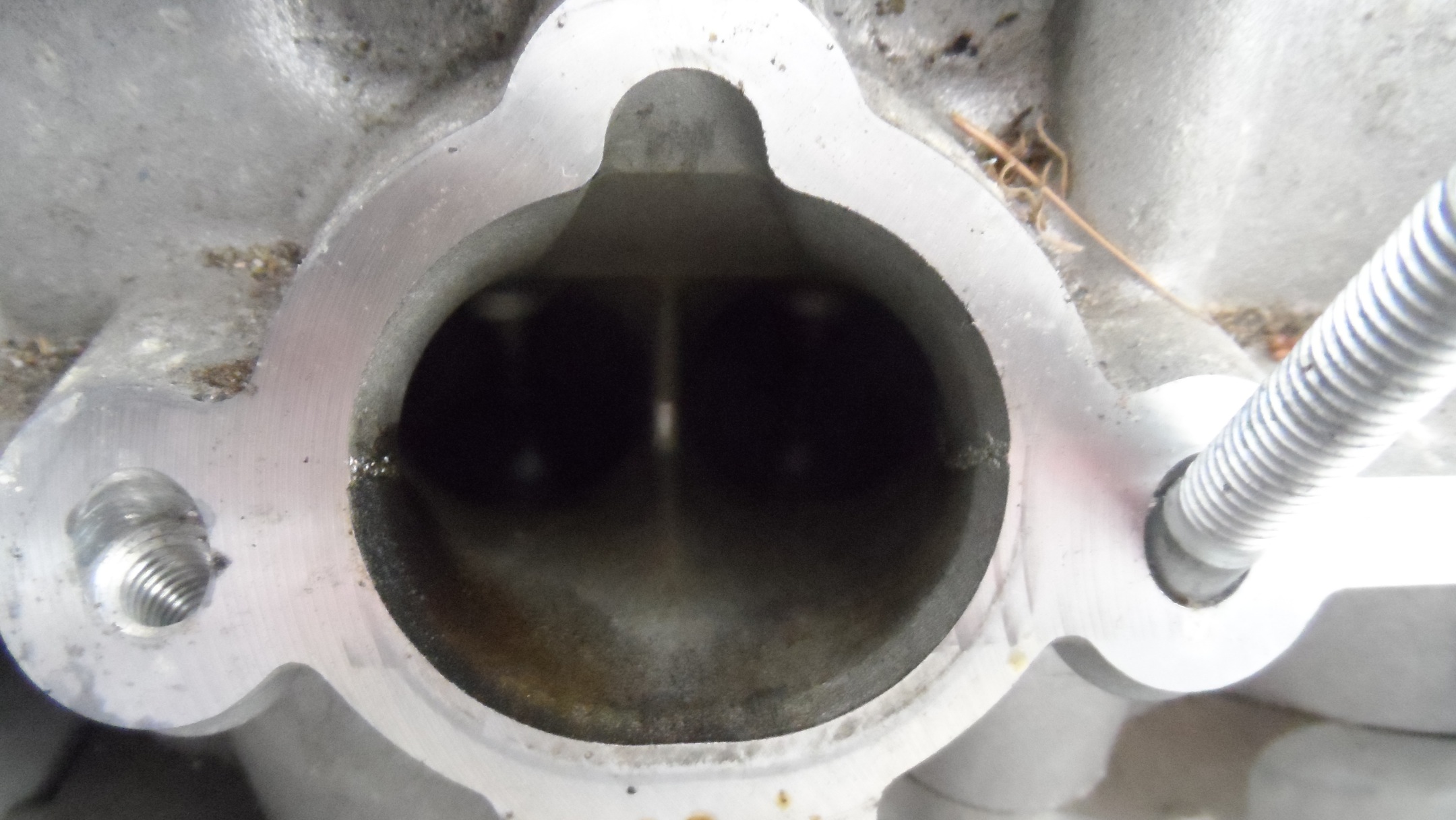

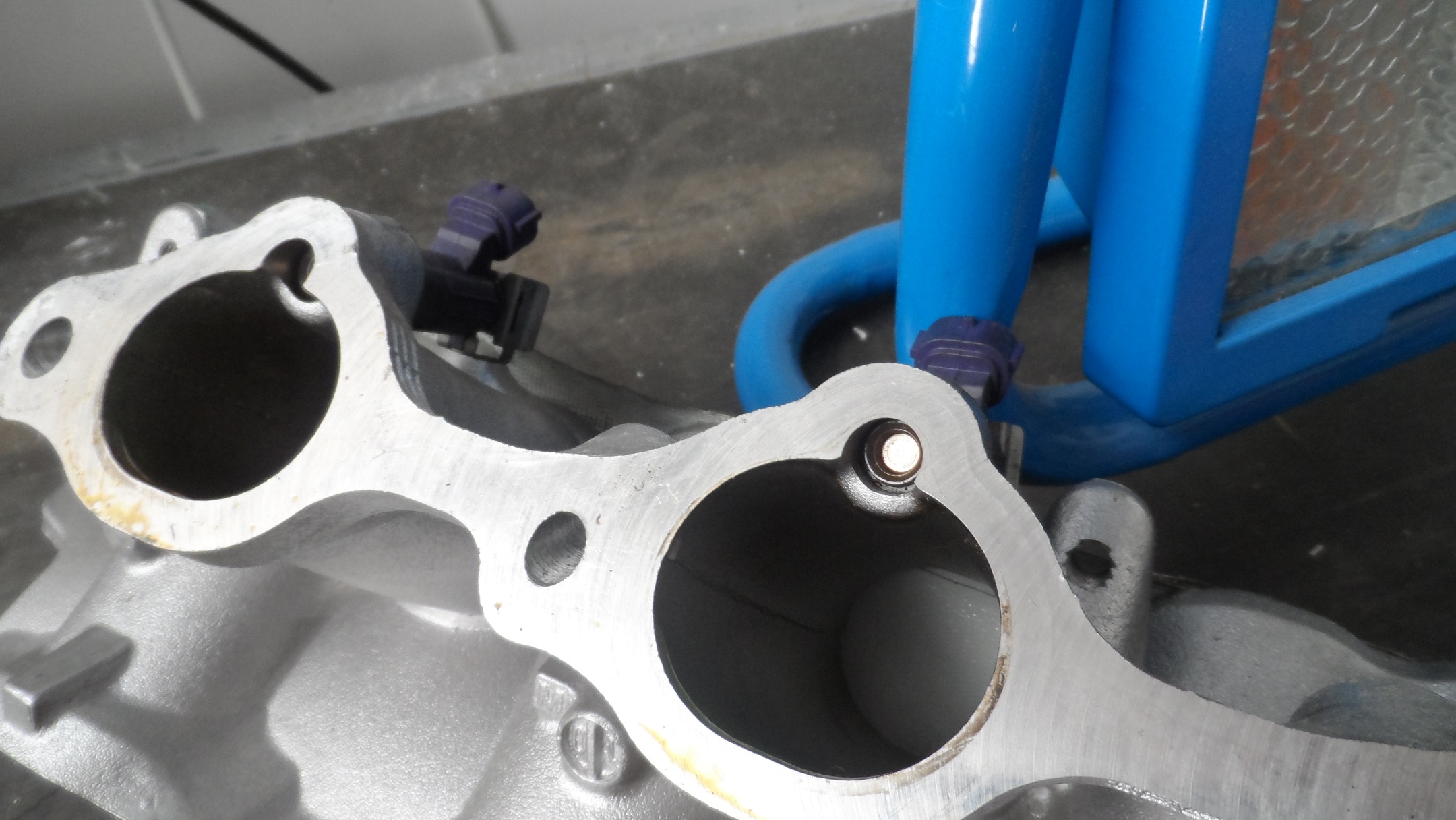

Jerry, as promised photo that prove there is no fuel in suspension in the upper & lower intake manifolds.
Photo 1 & 3. Injector vertically in place in the lower intake manifold 1/4" from the cyl head inlet port.
Photo 2. Cut out in intake port to deflect injector spray down and onto the back of the intake valves.
Consider this. Fuel is discharged at 51 psi in a narrow angled spray into a very high speed & volume airflow less than 2" from the combustion chambers
The only way fuel could get back up into the intake manifold ports is through reversion at low revs with a high overlap camshaft but the retarded cam phasing at idle in a 350Z negates most if not all of this.
Jerry. You have made many misinformed opinions as to my knowledge, ability & experience so I guess it's to much to ask for an apology when I have proved that the 350Z has a dry intake system.
Amongst the vast & varying information into air flow dynamics the general consensus is that that surface design is more important to wet intakes than dry.
Finally a piece of advise, don't attack the person by trying put them down & question there knowledge & ability, Debate the point not the person.
The OP statement that you took offence too. "cut & paste" was only littoral in the sense that there is very little original thinking & with the internet we can all become instant experts, myself included. Some of things you have said personally show you to be a real jerk.
I guess that last comment has F'''''d me for an apology

wow i dont think i need to say anymore to show FOS you are, 1) pressure is variable depending on setup, 2) it is hardly a "narrow spray" the spray fans are as much as 40 degrees in some setups, a 40 degree cone setup at that thats ****ing huge. and most definitely hits the bottom of the intake, well if port that **** perfectly smooth eliminating tumble so that the air and fuel dont mix properly. 3) less then 2 inchs? its more then 2 inchs to the split between the to valves far much more to the combustion chamber 4) the indent is there not to deflect it but so that fuel can even get in the chamber if it wasnt it would hit a solid wall of metal.
you also continue to ignore any comments on the effect of tumbling/turbulence and how it affects fuel mixing even in the cylinder head itself after it has left the intake.
finally the correct term is *******, and yes you would be correct you would have a hard time finding people who have served in the military in wartime who arnt *******s. harvards actually done a study on it.
