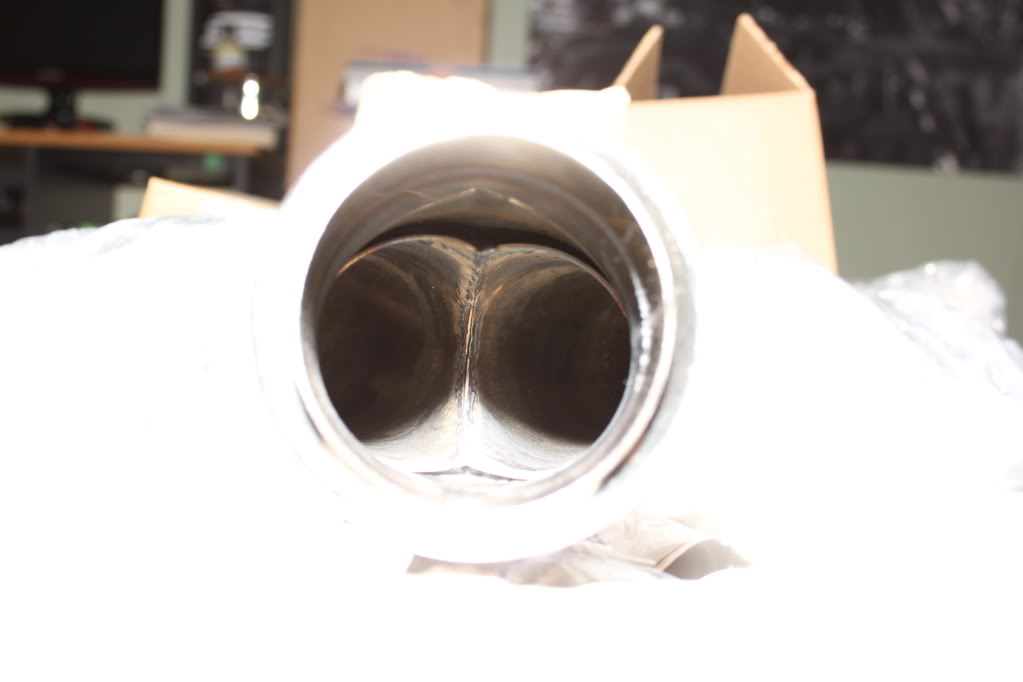

SOHO Y-pipe:
As far as low production exhausts go, I think it's a pretty good deal (cheaper than a full Motordyne exhaust by far), and you can't even argue Motordyne is a better design unless you do back to back dynos. Even if you did back to back dynos, it's very unlikely that any non-custom exhaust is going to add more than 15whp to a mild NA VQ build. I considered Tomei Ti Expreme & Motordyne, and price vs performance potential was a deciding factor in SOHOs favor.

No power lost, back to back dyno shows that. Slight mid-range improvement in power. Previous exhaust had dual 2.25 before x-pipe, and 2.5" from the x-pipe onward. This exhaust has a 2.5" y-pipe, and single 3" after the merge.
2.5" Y-pipe = (3.14 * 1.25^2) * 2 = 9.8125
Single 3" diameter = 3.14 * 1.5^2 = 7.065
...exhaust gas velocity goes up at the merge point (increasing scavenging effect), pressure goes down.
2.25" X-pipe = (3.14 *1.125^2) * 2 = 8.81125
Dual 2.5" diameter = (3.14 * 1.25^2) * 2 = 9.8125
...exhaust gas velocity goes down at the merge point (decreasing scavenging effect), pressure goes up.
I'm sure there's some more scientific people out there that can better explain all this stuff. Someone correct me if I'm wrong here. I'm really a novice with the all the Bernoulli's wizard magic stuff

James, you are correct the two pipes that are coming off of the manifold are in a state of higher pressure, thus low velocity is seen in these pipes once the pipes come together at the merger and into the larger diameter pipe, they are able to enter a state of low pressure and high velocity. Thus this low state of pressure that the exhaust gases are entering allows the scavenging effect to take place and thus create a vacuum effect and help the exhaust gases exit the engine faster.

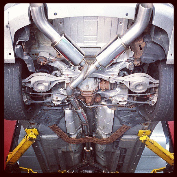

Our Dual exit catback exhaust looks like this...
