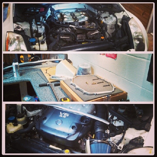

What was installed?
z1 spacer and jwt popcharger
How was the directions and installation of the z1 spacer?
It was straight forward they did word what washers to use wrong but being logical it was caught and corrected via not enough washers for bolts supplied. I had to look up on line to see the amount of washers to use for the strut bar clearance and made sure I had a 1/4 inch of play from strut bar to the lowest point of intake manifold so it would vibrate under load.
How was the directions and installation of the pop charger?
Straight forward hardest part was drilling the holes in the intake ram duct for the small screws and tightening them. They should of came with small bolts and nuts instead of screws.
How was the performance increase of the z1 spacer?
I believe the avg of 10hp is correct on my butt dyno... It makes the power more usable and more tq down low (2k-3k) but definitely a noticeable gain and well worth the time in doing this mod.
Why didn't you go with motordyne spacer?
Your paying for the name it is a angled spacer there is no ***** wonka secret here.
How was the performance increase of the popcharger?
Before the flame starts yes it is a placebo charger and being that I have an 05 without the magical velocity stack in the 06 box I decided to go with the pop charger, it whistles and makes noise no gain is what it is.
All in all I recommend the z1 spacer to all de enthusiasts, the pop charger is a preference type mod... Any questions please ask I would be happy to help!
