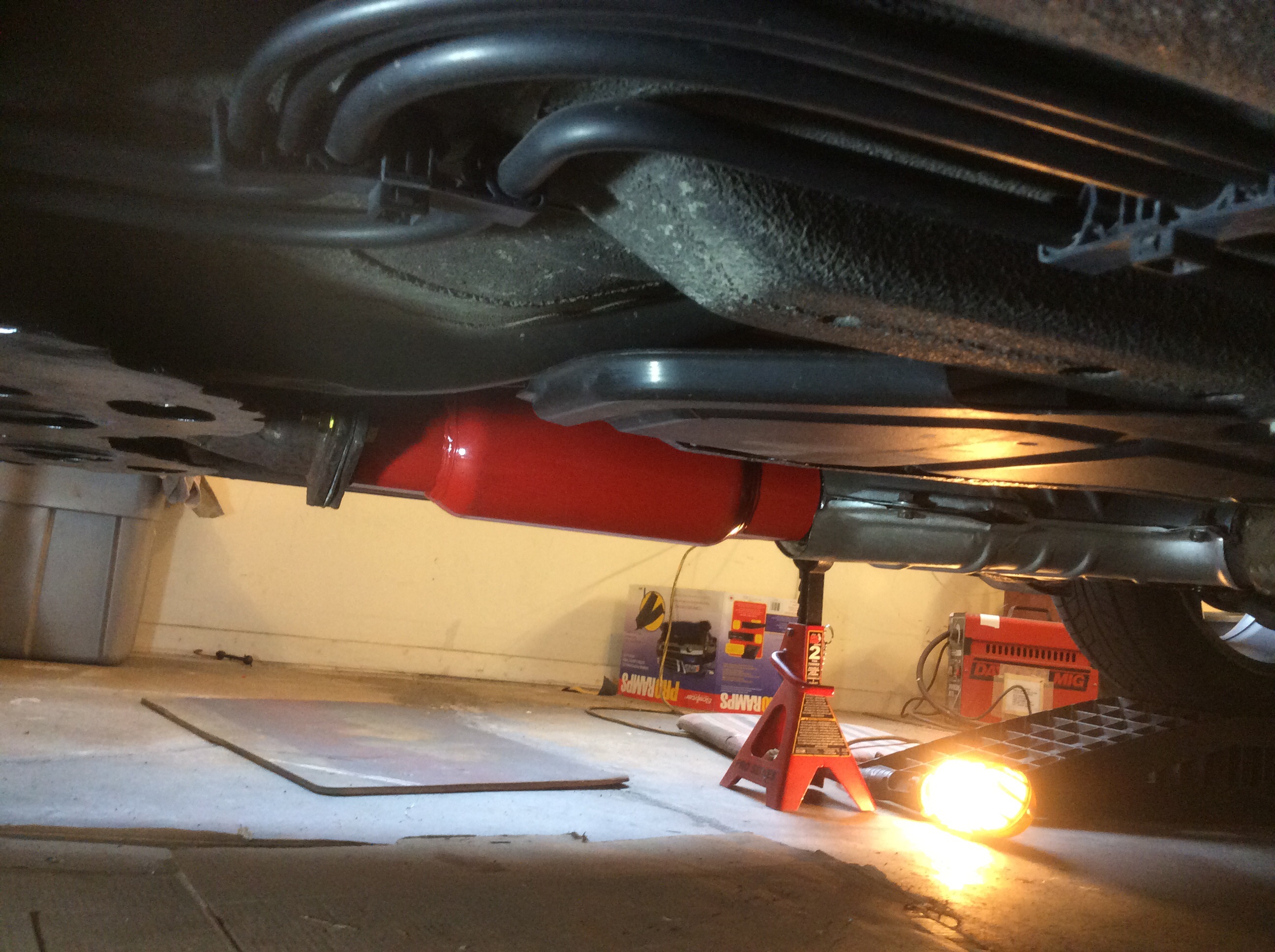

I put test pipes on mine and hated it, too loud,raspy,etc.
My poor boy solution was to cut a piece out of the stock Y pipe and put a 12" cherry bomb in its place. The 2.5" slipped right over the pipe.
For 36$ I got rid of all rasp, it's a little louder than stock, but not obnoxious, just right for me. Not sure if there is any gain over cats, but sounds much better.

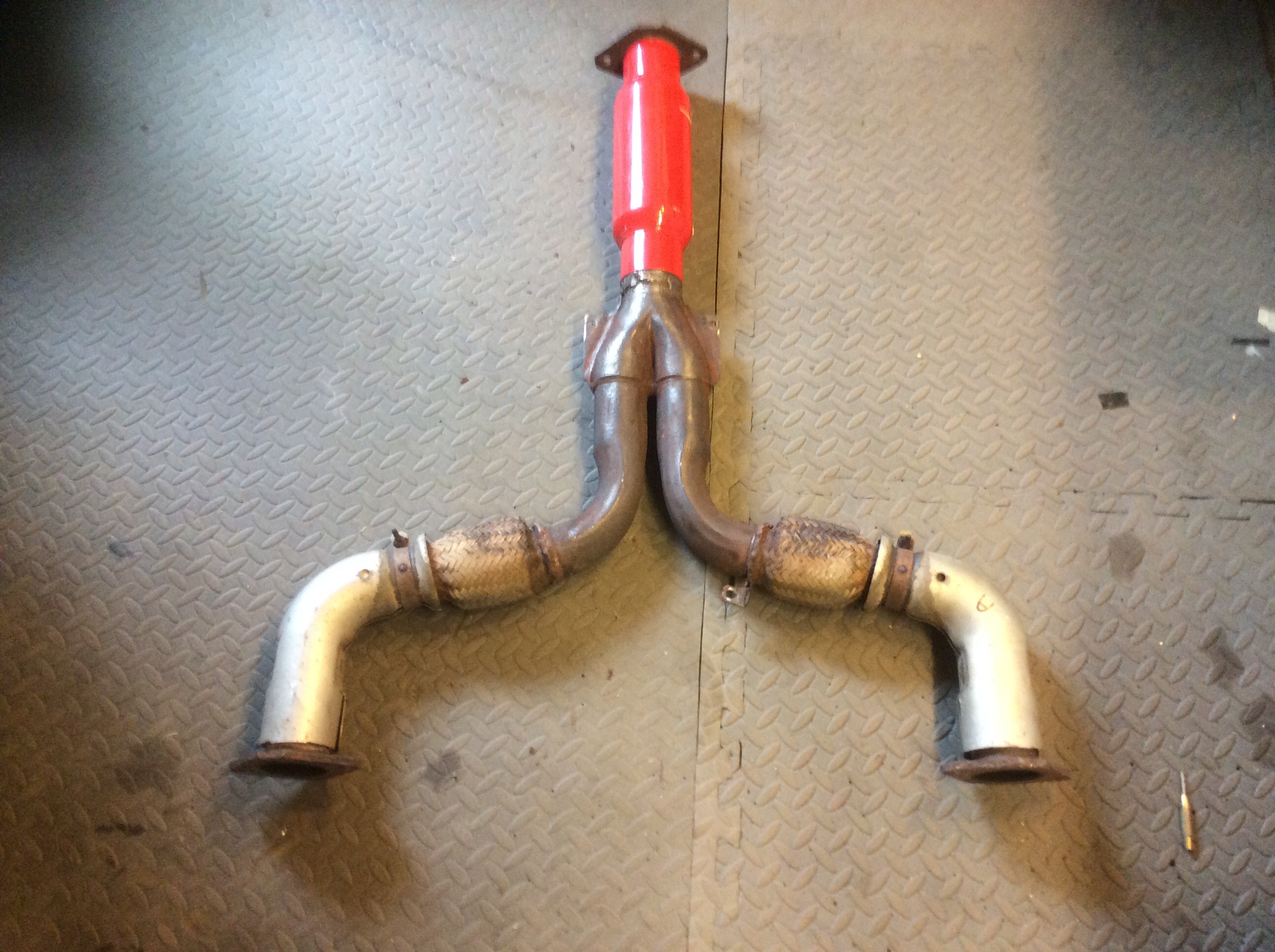

Is that the OE HR y pipe? Jesus thats beautiful and so much nicer than the DE one.
On the hunt for one now...
No,that's the DE one with the heat shield off. I trimmed the heat shield and put it back on. I installed band clamps after this pic and no leaks.

Originally Posted by 1973camarolt
Blufc3s, your car sounds lovely. I want to copy your Y-pipe idea on my car. Can you list what exhaust components you are using in the airstrip video?.
Thanks
The exhaust is stock except for some flex test pipes and the cherry bomb glass pack part # 87522.
Off topic, but you will notice in the pic some hockey pucks between the jack stands and the car.
I cut a groove in them and velcro them to the car, so they stay there all the time.
