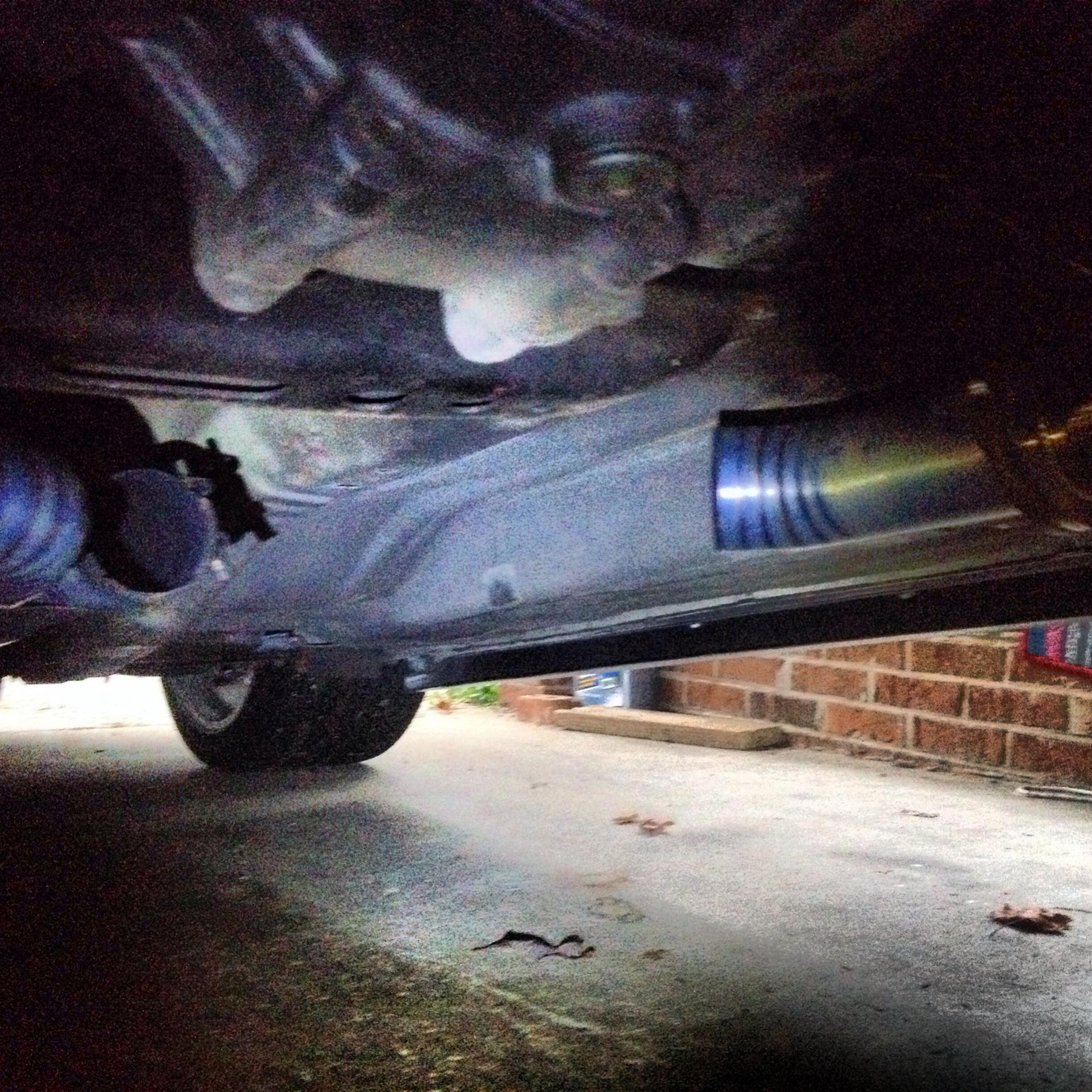

Here is a pic of where mine broke. Never noticed a crack before and I've been under the car a lot lol. Taka is the same guy I spoke with.

That looks bad. lol Glad you got it replaced. Taka is a cool guy. I'm telling you the people in japan really take pride in their product especially Tomei. Anyhow, I was just wondering if running that y pipe with no flex joint would cause anymore stress to it when the engine flexes during driving.

I think most of my problems came from my back firing or so. It broke right at the sharpest bend past the test pipes. I think I'll prolly still switch to the motordyne y. Don't really want to get rid of this tomei, might just hang it on the wall in garage or something. I'm just glad I found a company to stand behind their product and help me out.

If a y pipe fails like that it's probably for one of two reasons.
First, no flex joints and the little movement the engine naturally has stresses it enough to fail over time.
Second, you have a bad motor or trans mount causing a lot more movement and the lack of flex joints can't handle it.
