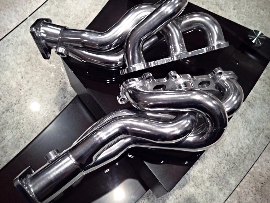

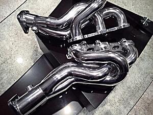

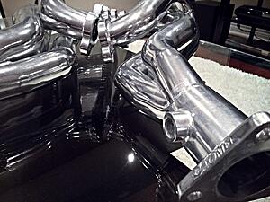

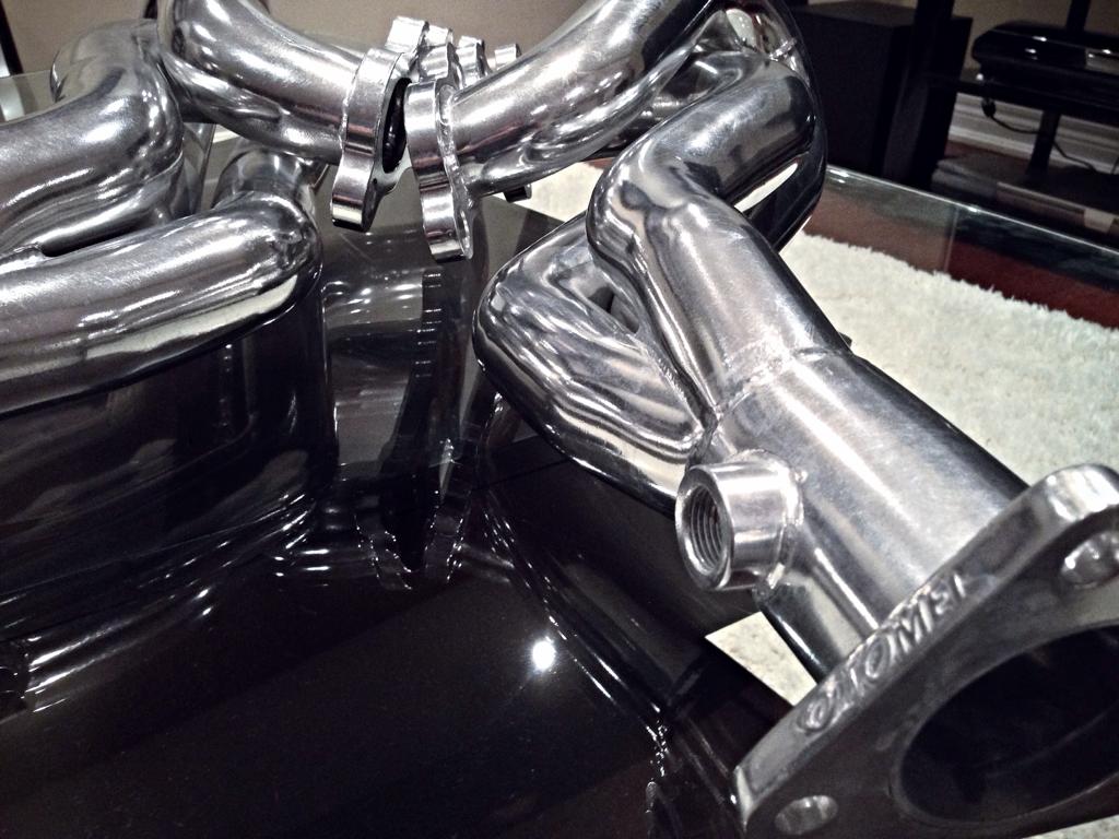

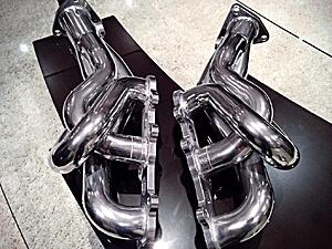

Mark at Fireball Performance Coatings did an awesome job... I went with the polished coating.
