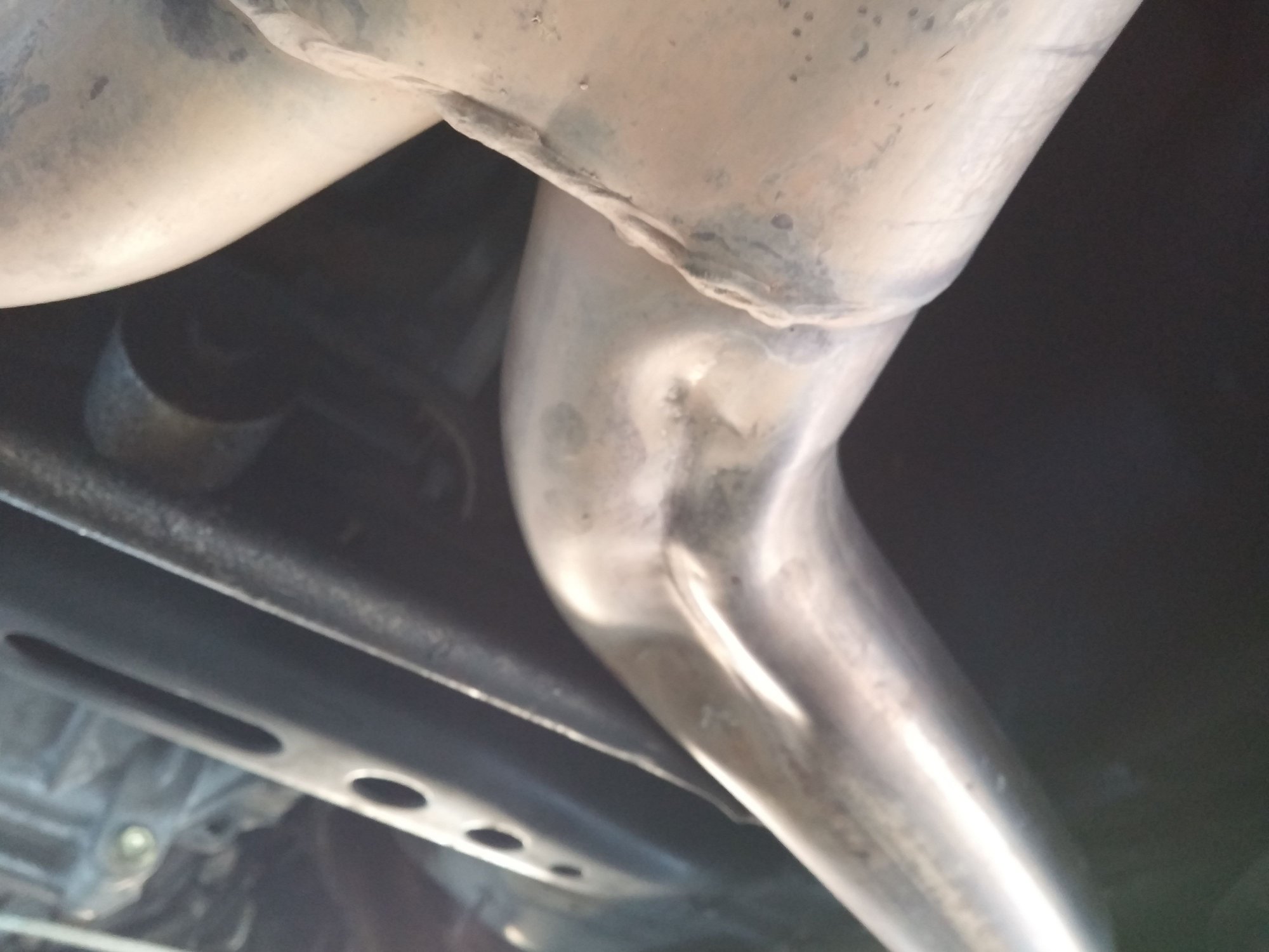

I'm going to take some videos and try to post so people can listen. I also have a pretty big dent in the passenger side exhaust pipe right near the y junction. I'm wondering if that may cause it?

I will get it on a rack asap. I crawled under to take pictures of the dent. Not sure if this link will work.
