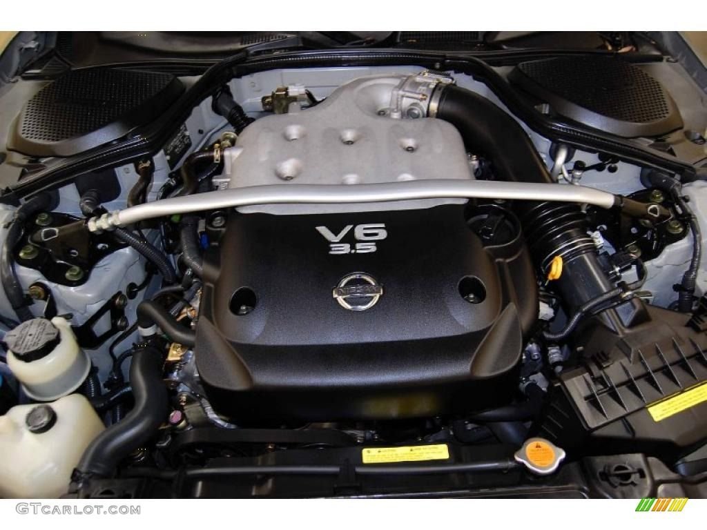

I just ordered the basic Motordyne Plenum Spacer for my 2008 350Z. It has been brought to my attention my engine is different than those I have seen in youtube installation videos. They all have one air filter and one throttle body while mine has two of each??? Hey I'm no mechanic.
Have I got the wrong part? First pick of engine in videos I have found...the second pic is like my engine.

07-08 has the HR motor with dual intakes, the 03-05 have the single intake. The spacer is meant for the single intake DE motor. So no, it won't work on your car.

Y PIPE, and Cat-back exhaust are universal for all years (03-08).
Test pipes / catalytic converters are different, 03-06 are the same, and 07-08 are the same.
Your exhaust will be perfectly fine for the car and a good choice of exhaust at that.
As for the spacers, just return it, there is no benefit for it on the 07-08 engine.
