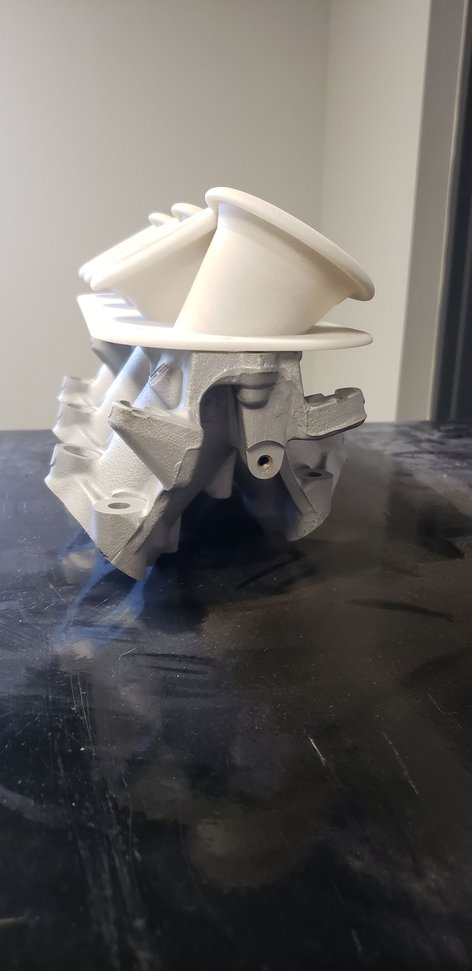

Old Apr 21, 2020 | 05:19 AM
MERLINMACHINING's Avatar
MERLINMACHINING
Joined: Apr 2020
Posts: 3
From: Wilmington
Default Setup makes alot of power up top
Here is a 3rd party dyno test. AFE intake, jwt c8 cams, 11 compression, short headers, highflow cats, and exhaust
300whp out of the hiram with and without our velocity stack prototype
green. Oem plenum with spacer
red. Hiram with vstack ( new revision soon with more gains)
Blue hiram without vstack
Check out our website www.merlinmachining.com

the vstacks are 3d printed test units to test any real world gains. The dyno shown with vstacks had some air leaks between ports from a design flaw so we need to retest that.
The HR hood with trimming or the fly1 motorsports hood is your best option. I have not cut the hood on a car yet.
The carbon upper is basically weightless and there is alot less aluminum on the car. So yes some weightloss is expected.
The entire point of this conversion is to be as cheap, versatile, simple, cost effective dollar/hp and visually stunning as possible.
any Holley hiram upper can be used. Yes the side mount ford versions will bolt on and i can support you with extra parts
Needed. Thats another pro for using this setup. There are air to water upper plenums and super low profile billet options available too with new options daily

I like the looks of the velocity stacks and I think overall they dyno’d better too. Do you think there would be any benefit to staggering the length of the stacks similar to the OEM nonrevup lower plenum? Or is the even possible without too much extra work?
