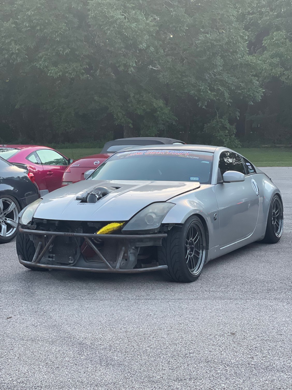

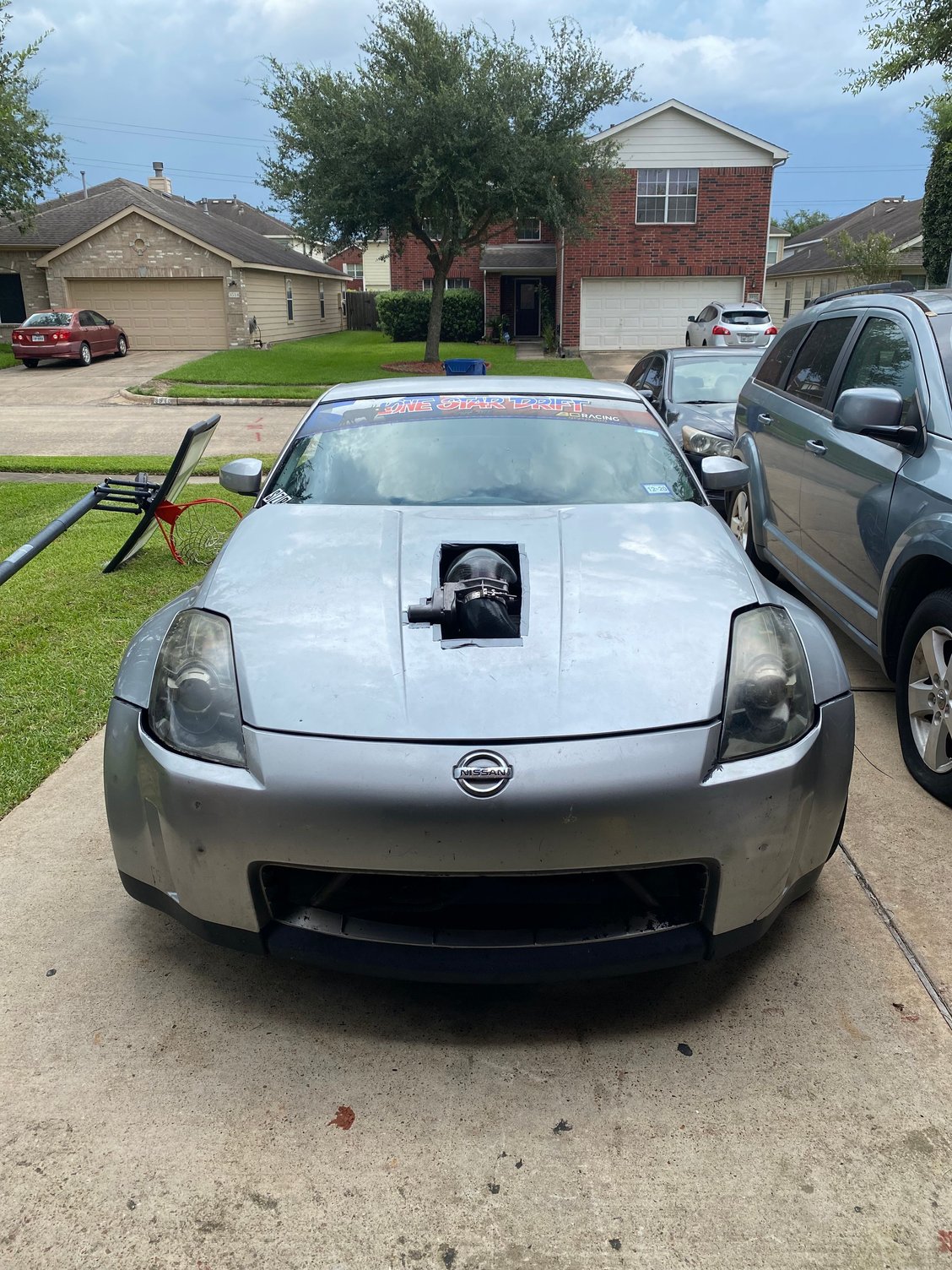

Originally Posted by dnash
How is the hood fitment? Got any pics?
