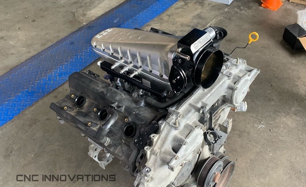

I was searching for intake manifolds and came across this:
I've reached out to a company in Malaysia called CNC Innovations, they make a whole bunch of nice billet intake manifolds for various cars, including our 350z's !
I basically wanted to get some info as I want to either replicate what Sasha did with his intake years ago or try something else (thus finding these guys), and said I wanted to share their website with the community.
I didn't really get much detailed info back in a couple of emails, so I thought ah might as well share what I found.
This is what I was looking at, strut bar does clear it, and can be front facing too if you are chopping up your hood:
https://www.cncinnovationsmy.com/pro...with-rotatable
(350z bits and pieces inc ITB's from 4AGE)
https://www.cncinnovationsmy.com/sea...&type=products
https://www.youtube.com/@cncinnovations1667/videos
Just wondering what you guys think ?
I'm clueless for 'fluid dynamics' stuff but overall this does look well designed but hey, not an expert here!
All I'm looking for is a more optimised manifold for my NA built engine.

If I order this, I'd go with a 92mm neck, LS throttle body, as it'll match the rest of what I've made.

I think the price is fair, you get:
Fuel rail
Plenum
Runner (52mm)
Teflon gasket
TB adapter
Fittings
Well the numbers thing, is kind of pointless to me because it's not my set up.
So I don't care what it does for a stock engine (and most companies wont show a tuned stock) in that sense, and I don't trust numbers as such.
You know what it's like, can easily be manipulated.
I'd like to know how it flows compared to the stock set up but yeah, I guess there's only one way to find out...
Although I've got to wait until house sale/buying is done.

To a degree you are right, except for the way it affects the powerband.
That cannot be manipulated, kinda like how Kinetix says the velocity does 30hp on a stock engine, true or not...it does shift the powerband upward and we know the stock manifold sucks for high end power.
No amount of mods will overcome the factory manifold, but if the Kinetix shifts it up you can only assume it will work better with other mods.
From a flow perspective I have 2 quarrels with it:
1. The neck is still bad like OEM.
2. The make the runners wider but no mention as to how they mate up with the head.
IMHO the best thing they have are those ITBS, the manifold would be great for a boosted car, for NA Sasha pretty much proved ITBS are superior to a manifold.

Yeah I see what you're saying.
It did shift it further upwards for me but I've either got something messed up in the engine build (I doubt timing but you never know) or it's just not optimal for my build.
Hey for all I know, maybe JWT sent me the wrong cams?
I don't think the neck is AS bad as OEM, larger and it's appears shorter.
Not sure about their runners but my ones are matched to the gasket/heads.
Just for a reminder, here is Sasha's old one:
Obviously has the large taper going into the main chamber to smooth out the flow and fill it up more evenly (at a guess).
Where as the CNC version isn't wide so I'm not sure there would be much of a downside to their neck design that's filling a central chamber if you see what I mean.
Obviously you could have it facing forwards but er, that'll make for an interesting hood
I'd love to go ITB's but that does bring an extra level of complexity, and **** ton of cost (granted their set up would knock it down somewhat).

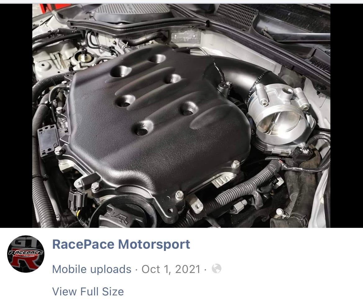

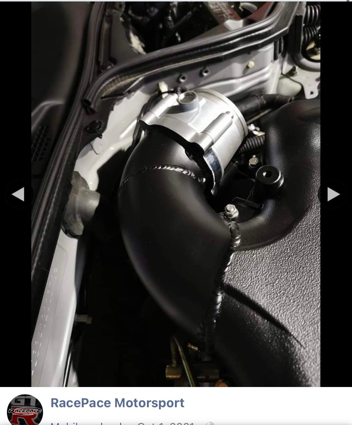

I did message Gareth from Racepace Motorsports (Melbourne/Aus) last year as I was keeping an eye on their facebook posts about the progress they made on their 350z (from modified stock plenum to itb's).
Their track car is largely stock but with JWT C8 intake with RZ2 exhaust cams, their headers are very similar spec as my PPE LT's (not off-the-shelf PPE long tubes).
'We cut off the back upper plenum inlet, and welded in a 3.5” inlet which was fed by a Bosch 82mm throttle body. 3.5” inlet into modified stock airbox. Also added a 2nd plenum spacer. We peaked this setup at 329whp @ 7600rpm'
We then got the ITBs from Jenvey. Most we got from the ITBs was 343rwhp @ 7600rpm.. We did gain a decent amount more torque in the midrange from the ITBs surprisingly.
Tried a few different velocity stack options, but weren’t able to get any more power. Tried revving to 8000rpm but no gains. So we found the limit of these camshafts.'

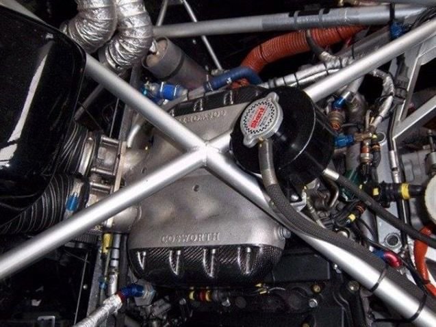

I was also looking at manifolds online and stumbled across this:
This is from a Renault Megane Trophy race car, but it must be an early version though, as all the others I have seen have a custom carbon plenum. I was looking at the race versions of the VQ that were used Europe to see if there was any interesting NA mods that I could apply to my build. Almost all of the hot VQ’s used for racing are running ITB’s, except for this version in the Trophy. This version was rated at 360bhp. They all seem to be running some version of dbw throttle body(s), (some have a large single unit.) This got me thinking, the Cosworth design, to me, has always seemed to underperform. I think because it has the same neck/TB restrictions as most other manifolds. Perhaps there is some performance to be unlocked in the Cosworth design if it were modified similar to Sasha’s or the Racepace Motorsport version.
The Cosworth intake internal design imitates the shape of ITB trumpets.
