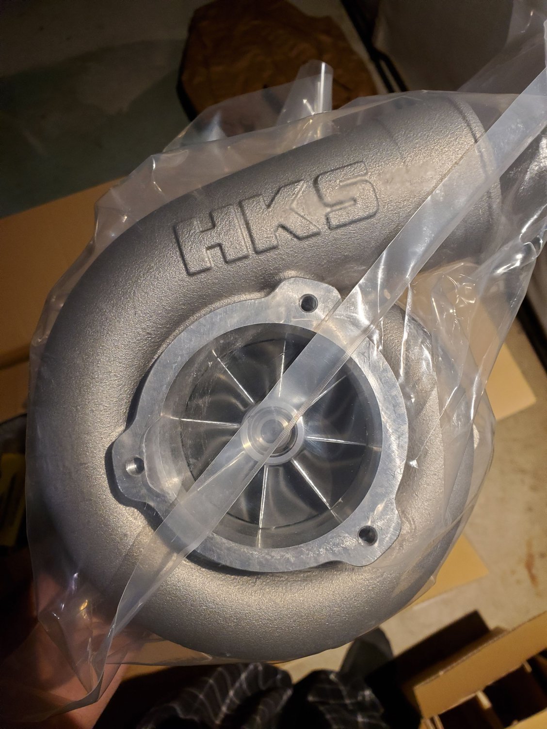

Also had this for a bit now but I'm not in a rush to install it as I don't believe in adding FI for minimal gains, if you aren't getting 150hp+ for it what's the point....
