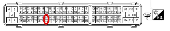

what took a long time is making sure I had the right wires on the ECU... It turns out the Factory Service Manual has the correct Pin numbers, but not Wire colors...
Here is that information on which wires to connect to the O2 simulator output to trick the ECU... (Note these colors are wrong, but the pins are correct... not sure if my colors would match yours.. but I will get those later):
bank 1 - pin 74 - W
bank 2 - pin 55 - B/OR
here is an ECU pin diagram to find the wires...
bank 1 - pin 74 - W
