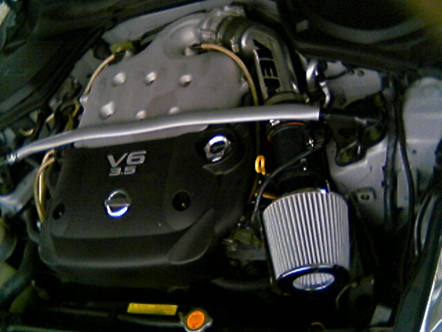

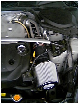

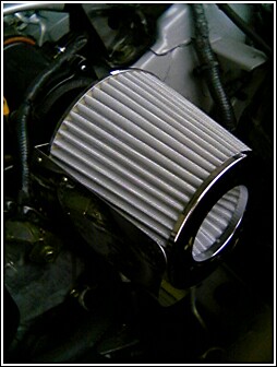

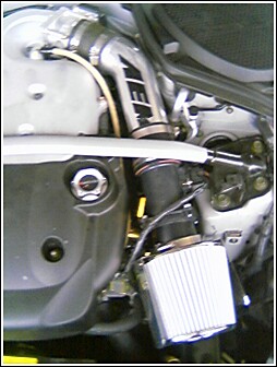

If you're in TX or watch the weather, you know it's been pretty bad here in San Antonio. And for some reason they put crubs on the side of ALL the access roads to help "direct" run off rain...well it directs it alright....it keeps it from running off at all. So there was so much water on the access roads it was almost comming over my hood just driving 10 MPH. Well wouldn't you know it....car just dies. I manage to get it started again after about 4 attempts, but can't get the RPMs to go over 3,000 without dying. So I just cruise down the access road at 10 MPH all the way home and immediately take the intake apart. FULL OF WATER, all the way up to the throttle body. I was so pissed. I got it all dried off and cleaned out. Then I attached a K&N Filter directly to the bottom of the MAFS turning it into a POP Charger of sorts. I also put a heat shield around the engine side of the filter around the bottom too.
Definately beware of water if you've got an AEM Intake.
I'll have pictures of my new setup tomorrow sometime.

Got a couple pics of my new setup...do I send them to someone to post them on here?
Old Jun 9, 2004 | 05:25 PM
Jetpilot718's Avatar
Jetpilot718
Posts: 2,136
From: Queens, NYC
Nah, you can attach them to your posts... see the bottom of the box and select the Browse... button.
Old Jun 9, 2004 | 05:50 PM
Infern0's Avatar
Infern0
Posts: 263
From: Lorton, VA
Yeah I knew that I've always used the "quick reply"
