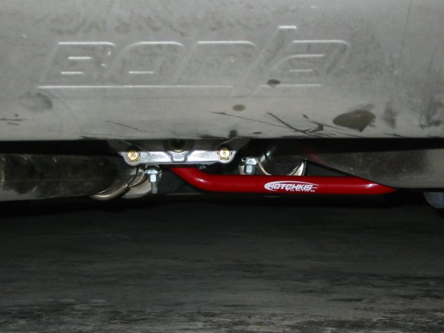

Here's a pic, it's not off of my car, but it should help. I love these sway bars, they are great.
Attached Thumbnails Hotchkis w/ Borla Exhaust fitment-sway2.jpg
I am 99.9 percent certain that's my picture from a previous thread. I LOVE these sways. I also have the Eibach springs. The handling is AMAZING. I tried a few different settings and personally found the Middle on the fronts and the Firmest on the rear to work the best for me.
Good luck, you'll LOVE the sways.
Install is not difficult at all. The REAR bar is a bit more difficult with the Borla on, but IF YOU take your time you can get the old bar off and the new one on WITHOUT taking anything apart on the Borla. If you are doing it without help, you may want to disconnect the Borla though....
