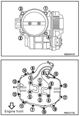

May I also suggest the following besides using a torque wrench? Slowly torquing them down in the specified order (skipping the center ones) in 3 or more rounds. Oh ... and take it easy with the 'red' thread-lock would ya.

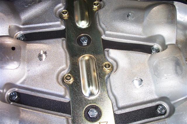

I installed my plenum today and used hex head screws like you guys were recommending. Here is a pic of them.

Hi, what were the bolt specs?
Thanks.
Old Jul 11, 2004 | 05:21 PM
zachcrosen's Avatar
zachcrosen
Posts: 2,259
From: Jacksonville , AL
Thanks.
I dont remember what they were. I just went to a local hardware store with one of the allen head screws that was supposed to go in it and they matched it up perfectly. All I remember is it is a 10 mm head.
