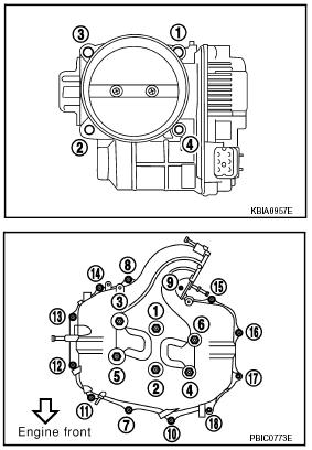

... still too early to tell at this point. But, I've already log'd over 700 miles on the V4 without any problems. Besides, using a torque wrench I would highly suggest slowly torquing them down in the specified order in 3 or more rounds (see attachment). Take it easy on the 'red' thread-lock. A small drop goes a longgg way.
The performance gain is significant enough for me to notice in a very positive way. I'll be heading out to the 1/4 track next week followed by dyno run some time after for quantitative analysis. It's looking good however.
