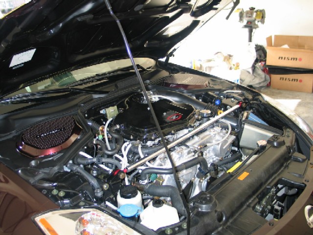

No real sounds different... or rough idling... I was just checking the installation while it was idling, because I installed it two days prior and was just doing a visual when I noticed the crack... then to make sure applied water to see if it got ingested in the crack......

Just one word, CRAWFORD, need I say more......

WAIT!!!! , I could be wrong, though I am VERY confident that I am not wrong. THIS IS NOT A CRACK!!!!!
This was posted in an earlier post because a user had the same question, this is a mold imperfection!!!
I have had people thinking that the "plate" is a metal plate reinforcemnt for structure purposes molded into the plastic, then expanding with heat and cracking there, not true!!
There are no metal inserts.
I have taken 3 pictures of a brand new plenum I unwrapped after reading this post with the imperfection, and yes it looks like a crack, but it is not. The imperfection is also coincidentally .... 2.25" long ( took a picture with a measureing tape.
Please dont jump to conclusions yet.
Also a crack in this region would almost be impossible!! We have literally smashed this section with a sledge hammer, and the frontal center section is bar far the strongest section of the plenum.
The "beading" of your water is because we armorall the plenums before they go out, though it likely does not penetrate into the mold imperfection, giving the hint that it may be a crack, because it looks like a crack too!!
If most of you would check, you will see the mold imperfection. Even if you have a new one sitting in your house, check and you will likely see the imperfection.
I will be posting pics in a few minutes as soon as I switch computers.

no I dont blame him at all!!!
because it sure looks like a crack!!
I am just receiving a wave of heat from the report. You guys are giving us all heart attacks over here.
This particular section of the plenum is about 1/2" thick and is partially molded in with the center support. It really is the strongest section of the plenum.
I apologize for the imperfection, but sometimes we get imperfections in tooling our molds and it is just too expensive to keep tooling looking for perfection.

Just for the record, I have the same imperfection on my V4 and its not a crack at all. If the crack was that large, you're car would really be idling badly by now... Perhaps this is a bit of a mistake? My v4 is running great.
