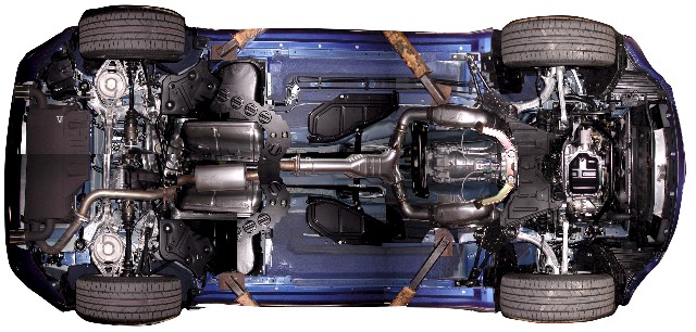

I'm trying to understand the exhaust system on the Z. I see alot of headers and cat backs for sale but I don't see anything about cats. Are the cats before, after or part of the Y-pipe?
Some exhausts (the one's they claim to be "true dual") see to take over rigth after the headers finish. Am I right? Does that mean that the cats are included?
It just seem silly to change the header and the cat back if there's still a restrictive factory cat in the middle. On my current/previous car, I changed the cat back, then the headers but until I got a high flow cat, I hadn't unleashed it's true power.
Can anyone give me some insight? And does anyone have a good underbody picture that differentiates all of the exhaust sections?

cats are after the headers and before the y-pipe.
true dual exhausts still start after the cats. they are true dual because they dont converge into one pipe as the y-pipe systems do.
the cats are the most restrictive part of the exhaust and you wont get the full potential until you change out that part. people who just change out the cat back systems do it mostly for looks and sound... imho.

Awesome picture thanks.
