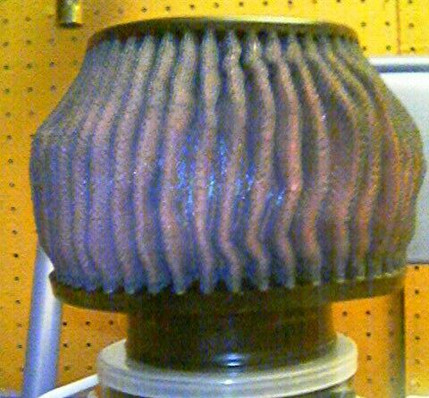

OOOOOOOOOOOKAY!!!!!! i was tryin out my system for the first time since the TC mod and i had a backfire. i must of had about 3 heart attacks. VERY LOUD pop and some smoke.
i pull over to find out that the intake tube popped off (injen CAI). everything was still intact. the only thing that happened was that where the rubber hose connects to the metal piping popped off. that section is usually clamped down, but i never got a clamp for it with the kit so i never put one on. i think if that clamp would of been there, worse things would of happened.
i guess with the clamp not being there pressure didnt get high enough to tear anything. however, my filter looks a little bit like a marshmellow. there is charring on the inside of the intake which is how i know that there was a backfire.
i still have no idea what caused it. imma spend the rest of tonight trying to figure it out.

ne way i just finished dropping in the new filter. i think im done with nitrous for this year. naw, im talkin crap again. imma up the shot tomorrow and try again n see what happens.
here's what my filter looked like after it went poof...
