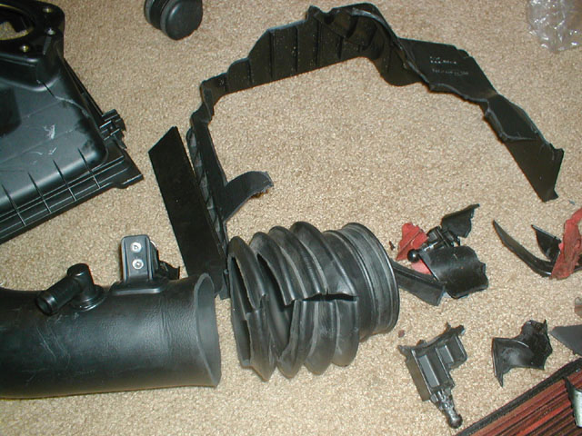

So I take the Z to the dyno again today to find make sure the nitrous system was running o.k. because of the low numbers I got last time. I sprayed it at about 1000 psi with 100 shot jets and only got around 280 something. Which is ridiculous because I got 321 on the same jets. I suspect an empty bottle so I purge and all that comes out is air. So I go get the bottle filled. Come back, strap it on, reheat the bottle to around 1000 PSI. We get on the dyno, in 5th gear, floor it, activate the spray, 2 seconds later...BOOOOOOOOM!!!! I swear to god I thought I was being punked or something. I see shiet fly all over the garage. At this point I'm thinking ****, my engine is GONE, I'm expecting to see a big azz puddle of oil and coolant on the floor, a hole in the block the size of my head, and a couple rods and pistons lying around. Luckily I see none of these things, however, I see remains of what used to be my intake, that shiet exploded.
At this point, I am holding back tears, I swear I was bout to go to a corner and start rocking back and forth in fetal position.

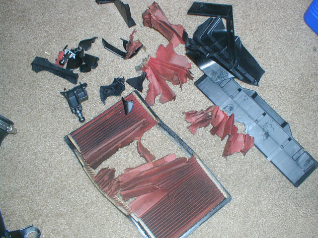

So I take it off and make an inspection of the engine, nothing really crazy, just filter element everywhere. So I call the dealer to see how much for a replacement (hoping to god my MAF wasn't ****ing blown) $430 something
, yea right, check performance nissans website, they got a nismo intake for 269. I ask the dealer if they have a nismo in and they say they do but their charging $439. Hahahaha, Riiiiiiiight!!!

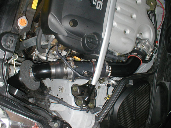

So I got the intake for 300 after taxes. I put install it, try to start it, starts up but doesn't stay on, I'M ****ED! I take out the MAF and try to clean it a little, come to find out I had the MAF installed backwards also (not sure if that was the problem or the dirty MAF). Put everything back in and it starts up and purs like a kitten.
What could've caused it? Not sure, could've been a couple things. What I'm pretty sure happened though is the nitrous/fuel mix that was in the intake system was ignited. I'm open to suggestions but as of now the nitrous system is out of commission and I'm calling NX first thing in the morning. Enjoy the pics

What happened was a nitrous backfire, duh, but I found out that it can be caused by an overly rich condition. Now the question is, why was it running rich? Reading up on that stuff has kind of freaked me out, I think I'm gonna google how to do a compression check and do it asap. I'm leaning towards failed or failing nitrous solenoid at the moment.
