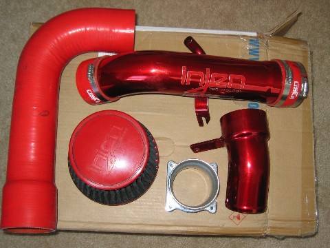

does this piece come with all the injen intake systems?
or just specifc ones? cuz i have the similar piece without the little piece where the hose attaches.
bought a used one off of someone and got the other piece instead.

As far as i know it comes with all of them. that attaches to the MAF and then there is a 15"(i think) thin hose that connects on that tube to an outlet on the side of the engine bay. Are you having a problem or just curious if it came with all intakes?

here's a picture of what i have.
just curious, cuz looking at other injen intakes...the piece looked different.

Yeah, Mine was different I guess, i had the red/polished kit. I had all that you see there except i had the metal piece that had the piece where the hose attaches and then I had a thin long hose that was red that connect to the metal peice and to the firewall. the piece hanging off the red pipe you have connects to the stock tube that connects to the rear of the engine block i believe. I'm not sure what to tell you though.

I'd try and take some pictures and show you mine setup on the car but i'm at work. If you haven't finished by tomorrow and still need help, i will be at home and can take some pictures and try and help you out. You should still be using the exact same setup as described in those threads you just dont have that thin tube that connects the metal piece to the firewall. I guess you got one of the very early ones, i dont really know.

It looks like instead of attaching the hose to the small piece that attaches to the MAF like we have, the hose will attach to the main tube (see the nipple sticking out of the piece that says Injen) on yours.

i thought the hose that attaches to the main tube is the tube that attaches to the rear of the engine block...... thinking back though now, i really can't remember if we have a tube that comes off the polished pipe. I haven't looked at that in a while so i can't remember.
